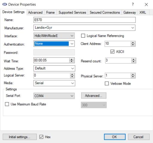

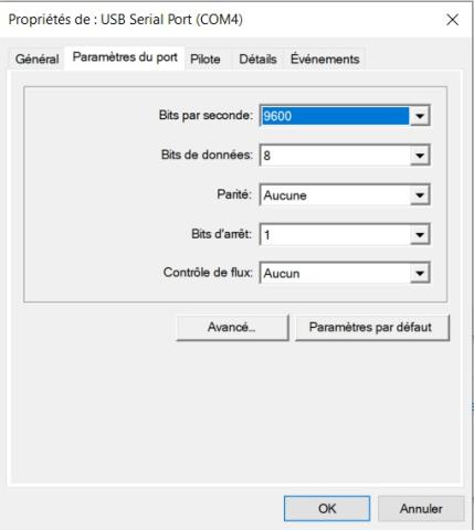

And I will send you picture of optical that i'm using and screenshoot of GXDLMSDirector settings for L+G E570 and my current serial port settings.

this is the GXDLMSDirector…
this is the GXDLMSDirector settings :

And my current serial port…
And my current serial port settings :

If you select HdlcWithModeE you should be able to establish the connection with your meter.
Your settings look correct. If you select "View", "Log" and "View Log" can you see if the meter sending any reply? At first, there is an IEC handshake and the meter should reply to that.
