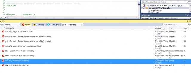

I am working on implementing the Gurux. c on my meter.. I tried compiling the "GuruxDLMSClientExample" on Microchip studio with gcc compiler but is giving me errors (I have attached Jpg file of errors)
Please how can I include the missing header file?
5 years 7 months ago
I believe that the best solution is if you create a new project for your compiler and then simply copy main.c- file and DLMS development folder for your project.

I created a new project for
I created a new project for gcc compiler and then copied main.c- file and DLMS development folder for my project. but still there are errors see on png attached.

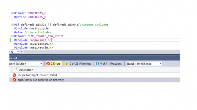

Your compiler is not supporting IPv6. Open gxignore.h and un-comment DLMS_IGNORE_IP6_SETUP.
poojash
Yes I already uncommented
Yes I already uncommented DLMS_IGNORE_IP6_SETUP but still it gives these errors. whether I want to add these arpa/inet.h? and Where I have to add this?
Get the latest version. Include order is changed. What gcc version you are using? Can you run command below and add version information here.
gcc --version

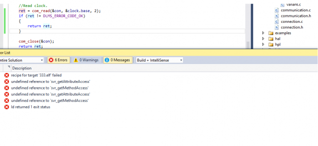

I compiled by using updated development files but there are some errors.
I compiled step by step main.c then I recognize that when I comment "ret = com_read(&con, &clock.base, 2);" this function then code compiles but when I uncomment it shows me errors:
Un-comment the DLMS_IGNORE_SERVER.
poojash
Hello
Hello
Thank you.... Compiled successfully.
