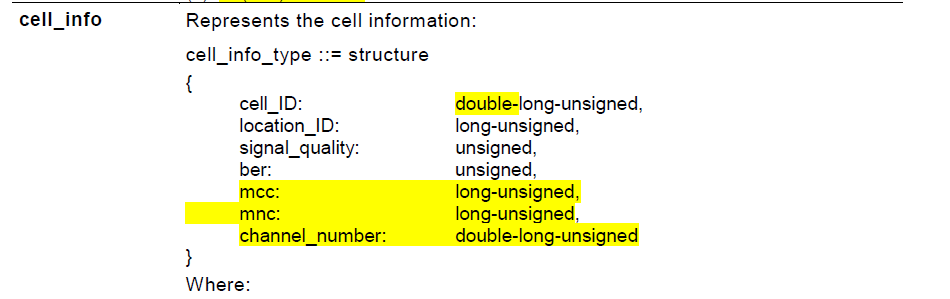

I am using GSM diagnostic class with version 1.
With Attribute 6 ,I did not get all parameters (MCC code ,MNC code ,Channel Number is absent)
is something is missing by me?
I kept Class 47 with version 1
following is the snap of object down load

Values are read and updated but it seems that UI is supporting only version 0 and MobileCountryCode, MobileNetworkCode and ChannelNumber are not update to the UI. This is fixed for the next release.
