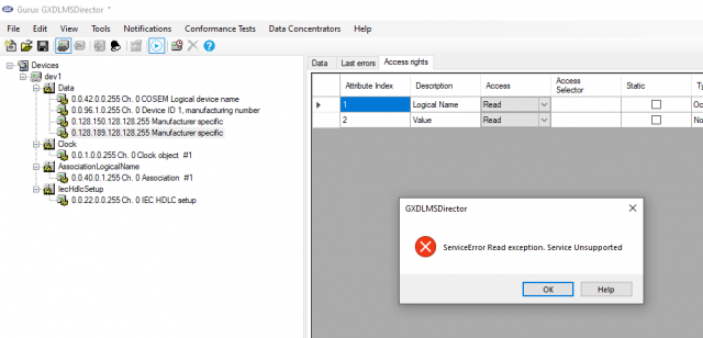

I am trying to read the energy meter em101+ from L&T using optical cable. I could see the connection getting established in the LCD screen as well as in dlms director gui.
But when I try to read further for serial number etc I get
"ServiceError Read exception. Service Unsupported" message. Wondering what could be the problem. Any suggestions ? screen shot attached
Do I required any authentication additionally ?

Have you checked checked "Use Logical Name" from the meter settings?
xloving
5 years 7 months ago
Yes I was. There was an
Yes I was. There was an update to the application yesterday and after that this problem is no more seen
While I am not sure what was the problem, things are working now
Thank you
