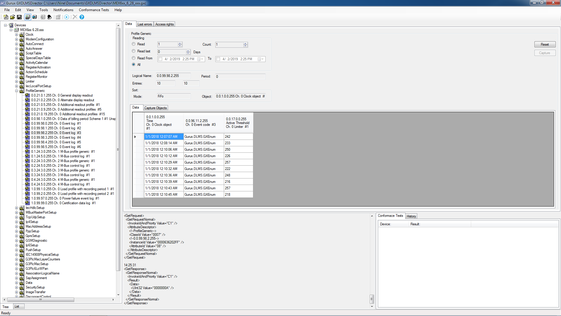

I would like to report issue with Profile Generic Buffer not displaying column value of type Enum in user interface. As you can see from "Profile Generic after read.png" the middle column of type enum in user interface has now "Gurux.DLMS.GXEnum" instead of actual value, this was introduced in last update, in earlier version this Column was showing actual enum value and was working fine.

Thanks for pointing this out. This is fixed and a new version is released today.
