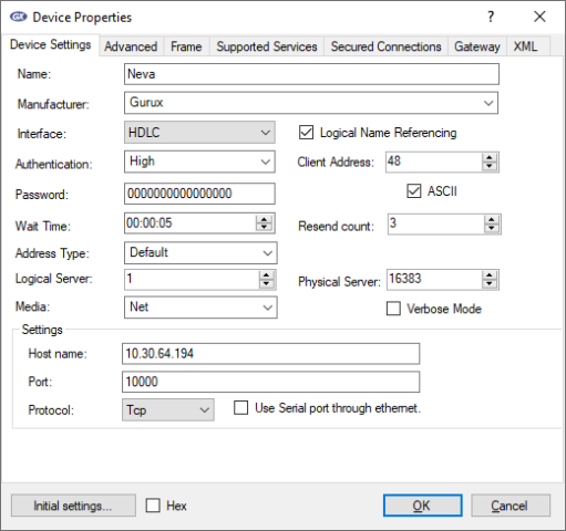

Hello. I tried to connect to the counter and got this error. What could be the problem?
GXDLMSDirector 9.0.2404.1801

Gurux.DLMS.GXDLMSException: Connection is permanently rejected. The application context name is not supported.
Meter expects Logical Name referencing with secured connection.

Hi, Your meter expects a…
Your meter expects a secured connection. Select "Secured connections" tab and change Security to AuthenticationEncryption. Then set block cipher and authentication keys.
DenisMalakhov
2 years 2 months ago
Do I need to get these keys…
Do I need to get these keys from the manufacturer?
Hi, Yes, the keys are…
Yes, the keys are usually coming with the meter. Some meter manufacturers use the same keys for all the meters, but usually, there it's own key for each meter.
