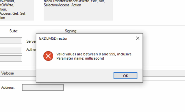

After clicking ok to the "Access Error" and attempting to read again by clicking on the meter name and then clicking "read," I receive another error:
"System.ArgumentOutOfRangeException: Valid values are between 0 and 999, inclusive. Parameter name: millisecond."

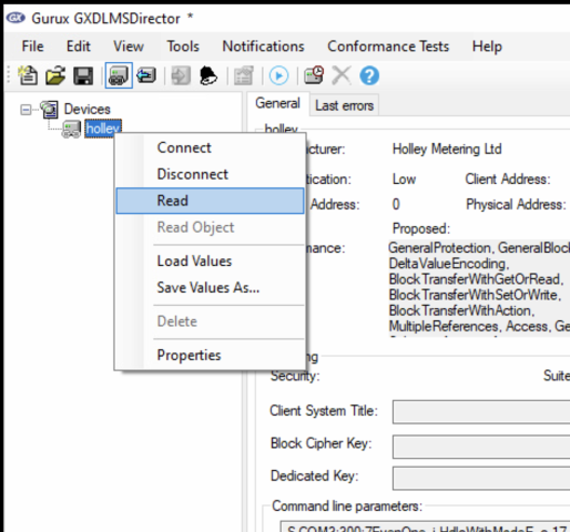

this i how i am reading after the access denied error

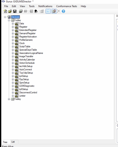

When i clone the meter i got these attributes
