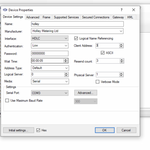

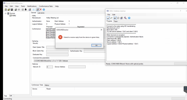

I am getting Failed to receive reply from the device in given time. when i am trying to connect with com-port and and getting Connection is permanently rejected. Authentication failure. on HDLC Address resolver . i am stuck and unable to connect please help .
muhammad ahmed
2 years 4 months ago
These are the setting

Hi, HDLC address resolver…
HDLC address resolver shows that you are using the optical probe. Try to change the interface type from HDLC to HdlcWithModeE.
