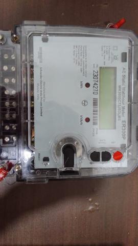

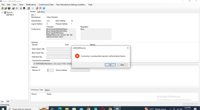

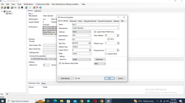

By javid123 , 25 August, 2023 Forums DLMSDirector i have AC Static Watthour Meter WR300P WR300BC73JSDLMS it has Rs232 feature . i unable to communicate with the meter please guide me . Image the settings the settings Image the result i got the result i got Image The meter i am using The meter i am using Image Hi, I try with Larsen &… Hi, I try with Larsen & Tourbo Aurora meter and it worked without problems. https://www.lntebg.in/products-services/products/meters/residential-com… Check your password. It might be that some one else has changed it. BR, Mikko YES sir you are right ,… YES sir you are right , password missmatch . hello javid123 I am facing… hello javid123 I am facing the same issue. Can you please guide me for connection?

the settings
the settings
the result i got
the result i got
