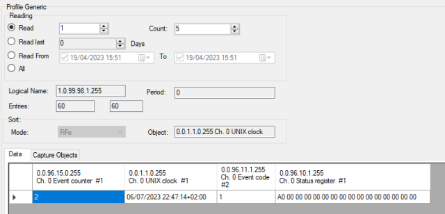

I am currently trying to read profiles. Since they can get very large, I read them row by row. However, when the reading process is complete, DLMSDirector shows only the first row that was sent by meter.
I observed that the meter correctly executes svr_getRequestNextDataBlock to get successive rows after the first one.
Data is also exchanged and seems to contain the contents of additional rows, as can be seen form the logs. The logs provided are supposed to exchange 5 rows, although it seems one element is lost, probably due to a bug. The UI client, however, does not show anything past the first row, which data is [01 01 02 04 12 00 02 06 64 A7 28 52 11 01 09 10 A0 00 00 00 00 00 00 00 00 00 00 00 00 00 00 00].

I would like to note that, if I send rows in a single message, they all are displayed, as long they fit the data buffer.
