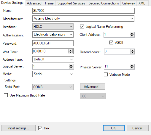

Could you please help me to connect to ACTARIS SL761? Thank you in advance.
GXDLMSDirector 9.0.2302.2001
Log created 21:59:19
Initializing serial connection.
Send SNRM request.
7E A0 08 02 23 03 93 3E 74 7E
Failed to receive reply from the device in given time.
Disconnect request
Send Disconnect request.
7E A0 08 02 23 03 53 32 B2 7E
à GXDLMSDirector.GXDLMSCommunicator.ReadDLMSPacket(Byte[] data, Int32 tryCount, GXReplyData reply)
à GXDLMSDirector.GXDLMSCommunicator.ReadDataBlock(Byte[] data, String text, Int32 multiplier, Int32 tryCount, GXReplyData reply)
à GXDLMSDirector.GXDLMSCommunicator.InitializeConnection(Boolean force)
à GXDLMSDirector.GXDLMSDevice.InitializeConnection()
à GXDLMSDirector.MainForm.Connect(Object sender, GXAsyncWork work, Object[] parameters)
3 years 6 months ago
Hi, Your settings look…
Your settings look correct. Change Interface from HDLC to HdlcWithModeE if you try to connect with an optical probe.
