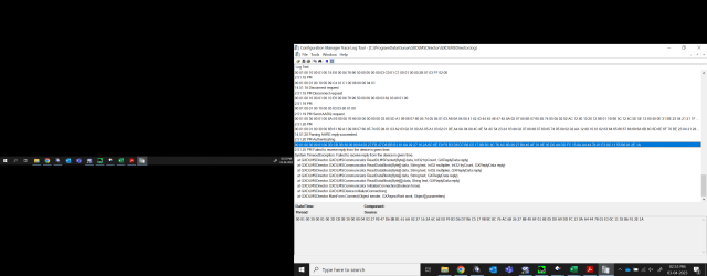

Hi, Mikko
i was trying to connect to a device by a gateway functionality and it is failing in authenticating is it because of the missing Phy address which mine is 76 90 50 00 00 00 00 03 i was able to connect in Public Client but not in MR or Utility settings can you please provide me so solution thanking you in advance
14.51.16 Send AARQ request.
TX: 00 01 00 10 00 01 00 2A E6 00 08 76 90 50 00 00 00 00 03 60 1D A1 09 06 07 60 85 74 05 08 01 01 BE 10 04 0E 01 00 00 00 06 5F 1F 04 00 00 1E 5D FF FF
14.51.17
RX: 00 01 00 01 00 10 00 2B 61 29 A1 09 06 07 60 85 74 05 08 01 01 A2 03 02 01 00 A3 05 A1 03 02 01 00 BE 10 04 0E 08 00 06 5F 1F 04 00 00 00 10 02 30 00 07
14.51.18
RX: 00 01 00 01 00 10 00 09 C4 01 C1 00 06 00 00 04 01
14.51.18 Disconnect request
TX: 00 01 00 10 00 01 00 10 E6 00 08 76 90 50 00 00 00 00 03 62 03 80 01 00
14.51.19
RX: 00 01 00 01 00 10 00 05 63 03 80 01 00
14.51.19 Send AARQ request.
TX: 00 01 00 30 00 01 00 6A E6 00 08 76 90 50 00 00 00 00 03 60 5D A1 09 06 07 60 85 74 05 08 01 03 A6 0A 04 08 41 42 43 44 45 46 47 48 8A 02 07 80 8B 07 60 85 74 05 08 02 02 AC 12 80 10 20 12 0B 01 1B 66 5C 12 4C 5E 5E 12 60 40 0E 31 BE 23 04 21 21 1F 30 00 00 04 02 4C 48 30 43 BF FF 02 E0 78 F1 90 74 F0 31 F9 82 2F D6 5C 37 A1 97 F4 DA EA 04
14.51.20
RX: 00 01 00 01 00 30 00 6B 61 69 A1 09 06 07 60 85 74 05 08 01 03 A2 03 02 01 00 A3 05 A1 03 02 01 0E A4 0A 04 08 4C 4E 54 4C 54 23 24 1B 88 02 07 80 89 07 60 85 74 05 08 02 02 AA 12 80 10 61 62 63 64 65 66 67 68 69 6A 6B 6C 6D 6E 6F 70 BE 23 04 21 28 1F 30 00 00 00 31 01 90 3A 56 90 39 93 B8 B6 BF CF 14 88 51 7C EC 8C 4F 4F 78 E5 E6 B6 E6 DC 72
14.51.20 Authenticating.
TX: 00 01 00 30 00 01 00 3D CB 3B 30 00 00 04 03 27 FB 47 D6 BB B1 61 6A 02 27 16 2A 6C 6E E0 F9 B3 D6 D7 B6 C5 17 9B BC 8C 76 AC 6B 26 27 B8 40 AF 01 8E 05 D0 A9 DD FC 13 0A A4 44 78 01 E3 0C 11 55 B6 91 2E 1A
14.51.25 Failed to receive reply from the device in given time.
