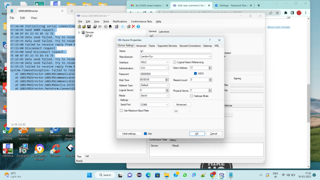

Hi Sir, No. iam unable to…
Hi Sir,
No. iam unable to connect. This is the log which iam getting.
these are the settings
-S COM8:9600:8NoneOne -r sn -c 17 -a Low -P 00000000 -w 1 -f 128 -t Verbose

Hi, If you are using serial…
If you are using serial port check that wirings are correct. If you are using optical probe, change start protocol from HDLC to HdlcWithModeE.
