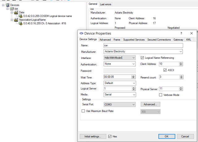

Hi Gurux team, please could you give me a hand. I'am trying to read data from Actarice meter using Optical Probe, thank you in advance.
Here are the results showing by GXDLMSDirector:
