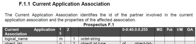

I have compared the frames and I have found, that conformance test requests Current association object as 0x15 instead of 0x0F.
Could there be a error in conformance test?

The reason is the client wants to read the AssociationLogicalName (0x0F) and the meter returns RegisterMonitor (0x15). The returned object is wrong.

The current association object clas_id is 0x0F. 0x15 is RegisterMonitor. I can't say anything with this information. Can you share the log file so I can check it? One reply doesn't help because I need to know what you have try to read.

3 years 6 months ago
Hi Ondrej, There are lots of…
Hi Ondrej,
There are lots of inconsistent class errors. You try to read objects that don't exists.
Try to read the association view again selecting "Refresh" from the "File" menu.
I believe that you have read this association from a different meter or using a different authentication level.
Ondrej_Pokorny
In reply to Hi Ondrej, There are lots of… by Kurumi
Hello Mikko, I have only one…
Hello Mikko,
I have only one client- Public Client- in Gurux DLMS Director.
I connect to it. I run Refresh. I can see Association LN class with address 0.0.40.0.0.255.
I close connection.
I run Conformance Test->Run->AllDevices->OK.
The attached log is the result.
BR Ondrej
Hi Ondrej, I'm sorry for…
Hi Ondrej,
I'm sorry for slow reply. There were some problems and I didn't notified from your email.
https://gurux.fi/forum-issue
This is now fixed. Get the latest version (9.0.2303.2301) from the GXDLMSDirector.
Ondrej_Pokorny
3 years 5 months ago
In reply to Hi Ondrej, I'm sorry for… by Kurumi
Hello Mikko, no problem, I…
Hello Mikko,
no problem, I confirm that the issue is fixed.
Thank You.
Best Regards
Ondrej
