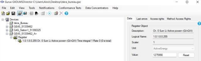

Hi community,
We are starting with DLMS with our Iskra meter.
The connection with a MT382 works perfectly with GXDLMS Director and we can get data from the meter.
I read the doc but I can't find the answer to theses questions :
1. So far we read and get the last data available from the meter with GXDLMS Director. In the futur we would like to make a code to get more data for this register (here Active Power+ in the picture). For exemple if we Read the meter at 12.00 can we get the date from 10.00 - 10.15 - 10.30 - 11.00 - 11.15 - 11.30 - 11.45 and 12.00 ?
Or do we need the read the meter every 15 minutes ?

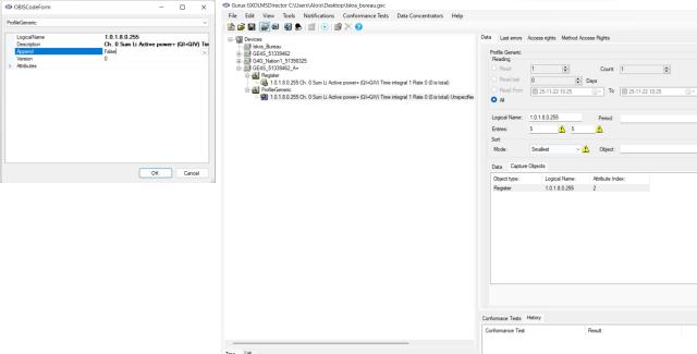

Hi Kurumi,
Hi Kurumi,
Is prefectly clear, in theory, thanks for your quick answer !
Thanks also for the code for Profilgeneric !
But can you tell me how to set up GXDLMSDirector to get the historical data for this register '1.0.1.8.0.255'. I mean the tab "Data" in my picture. I think this is the only thing I should set up ?
Thanks a lot for your help.

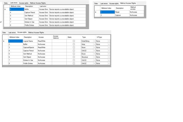

I saw on the forum on another
I saw on the forum on another topic that I should look at Rights but I don't know how to change it.
Here are a few more screen shots of my setup.
Thanks to you
3 years 6 months ago
You don't need to add objects manually. You need to read the association view. The association view will show all the objects and access ríghts. The meter decides what the access rights are and the client can't change them.
You can read the association view if you select "File" and "Refresh". Reading the association view might take a long time.

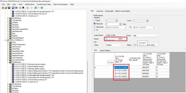

Hi again Mikka,
Hi again Mikka,
Prefectly clear. And now I can make it work and use it.
One last question to fully understand how it works :
1. I refresh the meter
2. I read the ProfilGeneric 1.0.99.1.255 with this case checked "Data -> Reading -> Read last 1 Days
3. I got a lot of data every 15 minutes (what is perfect)
Entries case was like : 180 and 18912
4. Than I refresh again and I only get now the lastest values.
Entries case is now : 4 and 18912
I have the feeling that when I read all the data I cannot get it once again, like if they were deleted from the meter. Is it correct ?
Thanks for your help
Data is not disappearing. In your post, you told that you have read the last 1 day (today and yesterday). In the picture, you have read zero days (today, starting from midnight).
