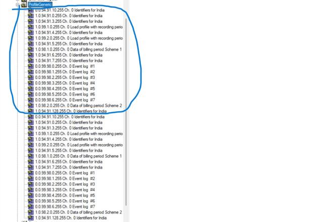

I am facing Object doubling issue when object list download.

Yes I am read successfully ,
Yes I am read successfully , but we see all object has double. Issue with Manufacturer "Indian Standard" . In the last version of GXDLMS director its ok.

Object doubling image are
Object doubling image are attached.
3 years 7 months ago
The meter is configured badly. The values are added twice for capturing objects or then there is an issue with the meter. Remove extra values.

why GXDLMSDirector trying to
why GXDLMSDirector trying to download undefined object whereas that object is not available in the meter.

GX always read all object
GX always read all object when trying to download object list with newly added devices.

My problem is resolved when…
My problem is resolved when uninstall GX application delete all temp and cache and restart PC then install again GX its working fine.
