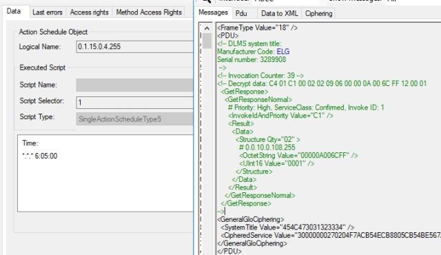

Hello Mikko,
The attribute Script Name of interface class 22 ActionSchedule is not displayed in box "Script Name".
For data please see attached screenshot.
Expected value is 0.0.10.0.108.255
Thank You for Your oppinion.
Best Regards
Ondrej
4 years 2 months ago
The script is not shown if it's not in the association view. If you add that to the association view you can see it.
Ondrej_Pokorny
OK, i got it.
OK, i got it.
Thank You, Mikko!
BR
Ondrej
