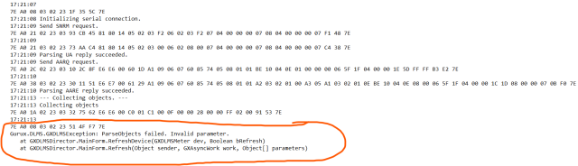

By tumza , 23 August, 2022
Hi Karumi,
I am trying to connect to EDMI Mk10M DLMS meter however every time i get the error "ParseObjects failed. Invalid parameter" when trying to refresh the objects list. Please see an image attached, what could possibly cause this issue? Thank you
4 years ago
The meter returns an error. Can you read the association view with authentication level None?
It might be that the association view is not implemented for this association.
Please add text in the future, not pictures. It's easier to read hex from the text.

15:40:58 Get profile generic columns...
7E A0 1A 02 23 21 76 D6 76 E6 E6 00 C0 01 C1 00 07 00 00 62 01 00 65 03 00 1B EF 7E
15:40:58
7E A0 12 21 02 23 96 31 0B E6 E7 00 C4 01 C1 01 03 73 82 7E
15:40:58 Reading object 0.0.98.1.0.102, interface ProfileGeneric
7E A0 1A 02 23 21 98 A6 78 E6 E6 00 C0 01 C1 00 07 00 00 62 01 00 66 03 00 7F 00 7E
15:40:58
7E A0 12 21 02 23 B8 4D C3 E6 E7 00 C4 01 C1 01 03 73 82 7E
15:40:59 Reading object 0.0.98.1.0.103, interface ProfileGeneric
7E A0 1A 02 23 21 BA B6 7A E6 E6 00 C0 01 C1 00 07 00 00 62 01 00 67 03 00 A3 5A 7E
15:40:59 Get profile generic columns...
15:40:59
7E A0 12 21 02 23 DA 59 83 E6 E7 00 C4 01 C1 01 03 73 82 7E
15:40:59 Reading object 0.0.98.1.0.104, interface ProfileGeneric
7E A0 1A 02 23 21 DC 86 7C E6 E6 00 C0 01 C1 00 07 00 00 62 01 00 68 03 00 64 10 7E
15:40:59
7E A0 12 21 02 23 FC 6D C7 E6 E7 00 C4 01 C1 01 03 73 82 7E
15:41:00 Reading object 0.0.98.1.0.105, interface ProfileGeneric
7E A0 1A 02 23 21 FE 96 7E E6 E6 00 C0 01 C1 00 07 00 00 62 01 00 69 03 00 B8 4A 7E
15:41:00 Get profile generic columns...
15:41:00
7E A0 12 21 02 23 1E 71 03 E6 E7 00 C4 01 C1 01 03 73 82 7E
15:41:00 Reading object 0.0.98.1.0.106, interface ProfileGeneric
7E A0 1A 02 23 21 10 E6 70 E6 E6 00 C0 01 C1 00 07 00 00 62 01 00 6A 03 00 DC A5 7E
15:41:01
7E A0 12 21 02 23 30 0D CB E6 E7 00 C4 01 C1 01 03 73 82 7E
15:41:01 Reading object 0.0.98.1.0.107, interface ProfileGeneric
7E A0 1A 02 23 21 32 F6 72 E6 E6 00 C0 01 C1 00 07 00 00 62 01 00 6B 03 00 00 FF 7E
15:41:01 Get profile generic columns...
15:41:01
7E A0 12 21 02 23 52 19 8B E6 E7 00 C4 01 C1 01 03 73 82 7E
15:41:02 Reading object 0.0.98.1.0.108, interface ProfileGeneric
7E A0 1A 02 23 21 54 C6 74 E6 E6 00 C0 01 C1 00 07 00 00 62 01 00 6C 03 00 05 73 7E
15:41:02 Get profile generic columns...
15:41:02
7E A0 12 21 02 23 74 2D CF E6 E7 00 C4 01 C1 01 03 73 82 7E
15:41:02 Reading object 0.0.98.1.0.109, interface ProfileGeneric
7E A0 1A 02 23 21 76 D6 76 E6 E6 00 C0 01 C1 00 07 00 00 62 01 00 6D 03 00 D9 29 7E
15:41:02
15:41:03 Reading object 0.0.98.1.0.110, interface ProfileGeneric
7E A0 1A 02 23 21 98 A6 78 E6 E6 00 C0 01 C1 00 07 00 00 62 01 00 6E 03 00 BD C6 7E
15:41:03 Get profile generic columns...
15:41:03
15:41:03 Reading object 0.0.98.1.0.111, interface ProfileGeneric
7E A0 1A 02 23 21 BA B6 7A E6 E6 00 C0 01 C1 00 07 00 00 62 01 00 6F 03 00 61 9C 7E
15:41:03
15:41:04 Reading object 0.0.98.1.0.112, interface ProfileGeneric
7E A0 1A 02 23 21 DC 86 7C E6 E6 00 C0 01 C1 00 07 00 00 62 01 00 70 03 00 33 53 7E
15:41:04 Get profile generic columns...
15:41:04
15:41:04 Reading object 0.0.99.17.0.255, interface ProfileGeneric
7E A0 1A 02 23 21 FE 96 7E E6 E6 00 C0 01 C1 00 07 00 00 63 11 00 FF 03 00 73 A5 7E
15:41:04
15:41:05 Reading object 0.0.99.15.0.255, interface ProfileGeneric
7E A0 1A 02 23 21 10 E6 70 E6 E6 00 C0 01 C1 00 07 00 00 63 0F 00 FF 03 00 8B 70 7E
15:41:05 Get profile generic columns...
15:41:05
15:41:05 Reading object 0.0.99.23.0.255, interface ProfileGeneric
7E A0 1A 02 23 21 32 F6 72 E6 E6 00 C0 01 C1 00 07 00 00 63 17 00 FF 03 00 EB 9E 7E
15:41:06
15:41:06 Reading object 0.0.99.19.0.255, interface ProfileGeneric
7E A0 1A 02 23 21 54 C6 74 E6 E6 00 C0 01 C1 00 07 00 00 63 13 00 FF 03 00 FB B3 7E
15:41:06 Get profile generic columns...
15:41:06
15:41:07 Reading object 0.0.99.20.0.255, interface ProfileGeneric
7E A0 1A 02 23 21 76 D6 76 E6 E6 00 C0 01 C1 00 07 00 00 63 14 00 FF 03 00 27 83 7E
15:41:07 Get profile generic columns...
15:41:07
15:41:07 Reading object 0.0.99.21.0.255, interface ProfileGeneric
7E A0 1A 02 23 21 98 A6 78 E6 E6 00 C0 01 C1 00 07 00 00 63 15 00 FF 03 00 63 88 7E
15:41:07
15:41:08 Reading object 0.0.99.22.0.255, interface ProfileGeneric
7E A0 1A 02 23 21 BA B6 7A E6 E6 00 C0 01 C1 00 07 00 00 63 16 00 FF 03 00 AF 95 7E
15:41:08 Get profile generic columns...
15:41:08
15:41:08 Reading object 0.0.99.98.0.255, interface ProfileGeneric
7E A0 1A 02 23 21 DC 86 7C E6 E6 00 C0 01 C1 00 07 00 00 63 62 00 FF 03 00 4C AD 7E
15:41:08
15:41:09 Reading object 0.0.99.98.1.255, interface ProfileGeneric
7E A0 1A 02 23 21 FE 96 7E E6 E6 00 C0 01 C1 00 07 00 00 63 62 01 FF 03 00 F7 B1 7E
15:41:09 Get profile generic columns...
15:41:09
15:41:09 Reading object 0.0.99.98.2.255, interface ProfileGeneric
7E A0 1A 02 23 21 10 E6 70 E6 E6 00 C0 01 C1 00 07 00 00 63 62 02 FF 03 00 3A 94 7E
15:41:10
15:41:10 Reading object 0.0.99.98.4.255, interface ProfileGeneric
7E A0 1A 02 23 21 32 F6 72 E6 E6 00 C0 01 C1 00 07 00 00 63 62 04 FF 03 00 A0 DF 7E
15:41:10 Get profile generic columns...
15:41:10
15:41:11 Reading object 0.0.99.98.5.255, interface ProfileGeneric
7E A0 1A 02 23 21 54 C6 74 E6 E6 00 C0 01 C1 00 07 00 00 63 62 05 FF 03 00 1B C3 7E
15:41:11 Get profile generic columns...
15:41:11
15:41:11 Reading object 0.0.99.98.6.255, interface ProfileGeneric
7E A0 1A 02 23 21 76 D6 76 E6 E6 00 C0 01 C1 00 07 00 00 63 62 06 FF 03 00 D6 E6 7E
15:41:11
15:41:12 Reading object 0.0.99.98.7.255, interface ProfileGeneric
7E A0 1A 02 23 21 98 A6 78 E6 E6 00 C0 01 C1 00 07 00 00 63 62 07 FF 03 00 6D FA 7E
15:41:12 Get profile generic columns...
15:41:12
15:41:12 Reading object 0.0.99.98.8.255, interface ProfileGeneric
7E A0 1A 02 23 21 BA B6 7A E6 E6 00 C0 01 C1 00 07 00 00 63 62 08 FF 03 00 94 48 7E
15:41:12
15:41:13 Reading object 0.1.22.0.0.255, interface IecHdlcSetup
7E A0 1A 02 23 21 DC 86 7C E6 E6 00 C0 01 C1 00 17 00 01 16 00 00 FF 08 00 18 4F 7E
15:41:13
Gurux.DLMS.GXDLMSException: Access Error : Device reports Read-Write denied.
at GXDLMSDirector.MainForm.RefreshDevice(GXDLMSMeter dev, Boolean bRefresh)
at GXDLMSDirector.MainForm.Refresh(Object sender, GXAsyncWork work, Object[] parameters)
4 years ago
There are lots of objects where only the logical name is implemented and there is no other data. For example, register object 1.0.21.8.0.255. There is an access right only for the logical name.
<Structure Qty="04" >
<UInt16 Value="0003" />
<UInt8 Value="00" />
<!-- 1.0.21.8.0.255 -->
<OctetString Value="0100150800FF" />
<Structure Qty="02" >
<Array Qty="01" >
<Structure Qty="03" >
<Int8 Value="01" />
<Enum Value="01" />
<None />
</Structure>
</Array>
<Array Qty="00" >
</Array>
</Structure>
</Structure>
The client application tries to read those values and you get a read-write denied error because of that.
The client application reads all the objects from the meter. You can read only values that you need and that are implemented for the meter. You can also ask if there is new firmware available for the meter where those objects are implemented.
