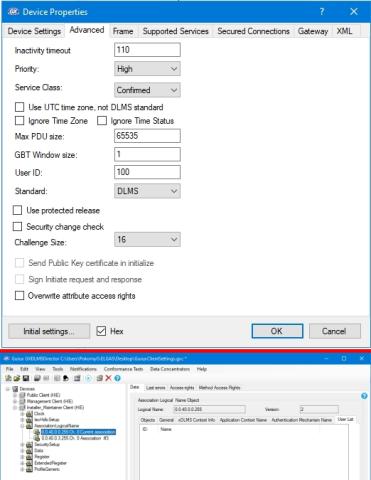

I have problem with HLS Autentization when users (userIDs) are defined in Server for the Association.
The userID value is filled in Director in Clients Properties->Advanced-> User ID.
If I remove users from Server and clear User ID field, HLS Authentization is correct.
Could You tell me, how User ID is passed in Application Association Request (AARQ) APDU?
Hello Mikko,
on the server side, there is only one user with ID==100 (decimal) and name "User".
On the Director side, I cannot see any users (see picture attached).
Maybe I cannot see them, because the Association view is from last succesfull association (as I have written before, it is the association without users).
The user ID is set to 100 in DeviceProperties->Advanced (see picture attached).
This is connection log (Director updated to 8.2.2208.0101):

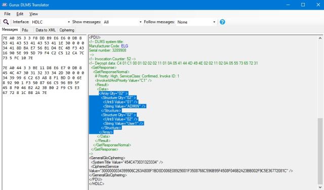

This is log from the Director and attached there is screenshot of the same messages in DLMS Translator:
9:14:23 Read object type AssociationLogicalName index: 10
7E A0 35 03 03 D6 A1 71 E6 E6 00 DB 08 53 41 43 53 41 43 53 41 1E 30 00 00 00 3B AB DE F2 D3 E1 68 C3 26 A3 AD 86 FF C1 36 84 7A DF 11 4A 62 48 E2 ED 67 F5 AC CB 7E
9:14:23
7E A0 44 03 03 9C 01 DA E6 E7 00 DB 08 45 4C 47 30 31 32 33 34 2D 30 00 00 00 3B E3 8B F3 54 DB DC E2 54 40 5E DF 35 85 81 A5 3A 4A 72 B4 74 E7 D2 22 72 DA A8 15 EC 83 AD 1F A6 A7 62 F9 B4 FD CE BB 74 2F 9E 7E
System.InvalidCastException: Objekt typu System.String nelze přetypovat na typ System.Byte[].
v Gurux.DLMS.Objects.GXDLMSAssociationLogicalName.Gurux.DLMS.Objects.IGXDLMSBase.SetValue(GXDLMSSettings settings, ValueEventArgs e)
v Gurux.DLMS.GXDLMSClient.UpdateValue(GXDLMSObject target, Int32 attributeIndex, Object value, List`1 columns)
v Gurux.DLMS.GXDLMSClient.UpdateValue(GXDLMSObject target, Int32 attributeIndex, Object value)
v GXDLMSDirector.GXDLMSCommunicator.Read(Object sender, GXDLMSObject obj, Boolean forceRead) v D:\Dokumenty\Visual Studio 2019\Projects\GXDLMSDirector\Development\GXDLMSCommunicator.cs:řádek 1904
v GXDLMSDirector.MainForm.Read(Object sender, GXAsyncWork work, Object[] parameters) v D:\Dokumenty\Visual Studio 2019\Projects\GXDLMSDirector\Development\MainForm.cs:řádek 2826

What value you are using in the user ID?
Is that used ID value listed in the "User list" tab of the Association view object?

does above mentioned settings seem OK to You? And how is User ID passed in Application Association Request (AARQ) APDU?
Thank You.

I am still trying to find a bug in User support on our side. Now I am struggling with reading UserList.
Could You help us, please? To make users support working is our main goal now.
Could You kindly comment my previous questions too?
9:14:23
Best Regards
Ondrej
