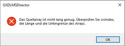

I am having trouble to communicate wth this meter.
I have received form the manufacturer only one long password, which makes me asume that this is a HLS meter using Authentication mechanism #2.
I got an association response value 00 but Gurux shows me a message in German (My pc is in German), which means somethinh like:
"The source array is not long enough. Check srcindex, the length and the lower bound of the array"
Would you please chech the log files and give me your comments?
Many Thanks
Frank

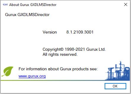

4 years 6 months ago
the version is 8.1.2109.3001
BR
Frank

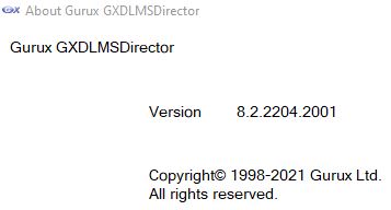

Update to the latest version so we can make sure that this is not any version issue.
Let me know if you have problems and we try to test with the German version from Windows.
Are you using Windows 7, 10, or 11?
Frank G
hi Mikko,
hi Mikko,
there is no updates available. I am using windows 10.
Hi Frank,
Hi Frank,
Remove your app and install the latest version. You are using the old version for .Net 3.5. That is available only for legacy reasons.

Frank G
I have done it. Unfortunately, I am getting the same error (srcindex)

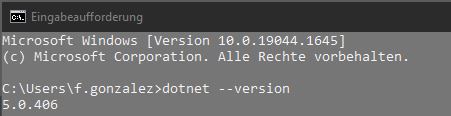

Can you run this and let me know what .Net version you are using?
dotnet --version

Frank G
Dontnet version 5.0.406
Windows version 10
Frank
