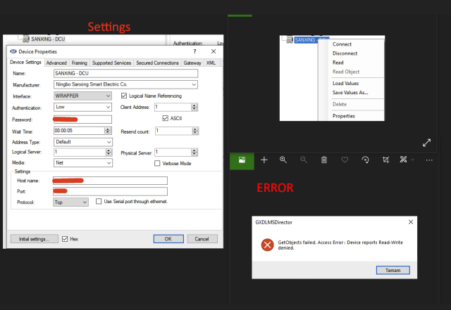

Hi.
I can connect Sanxing DCU from GXDLMSDirector with these settings in screenshot.
However i cannot read object list. It throws "GetObjects failed. Access Error : Device reports Read-Write denied" error (Error is also in screenshot).
Is there any other ways to read object list of that device or am i missing something.
Thanks for help.

You need to verify from Sanxing that you have the correct client and server address. That is usually the problem. Sanxing support is usually quite good, so just ask if they know the reason.

Hi Kurumi, thanks for the
Hi Kurumi, thanks for the reply.
Client and server address is already true, its already in the first post photo.
I also made connections with other dlms solutions, but our company is used to work with gurux.
Is there any other things to be done in program or is there any topic related to this device?

System.Exception: GetObjects failed. Access Error : Device reports Read-Write denied.

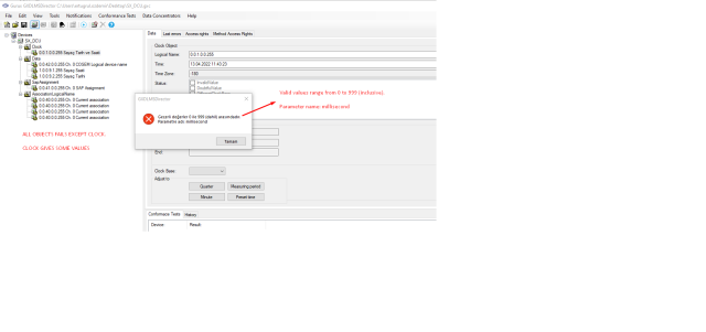

Hi Kurumi,
Hi Kurumi,
We can get all objects that meter gives, but we dont need meter objects. We need DCU objects, the way that you advise is didnt work. We cannot read meter as Public. Than we added clock object, we can read DCU clock but it gives an error, error is in below screenshot. Also we tried like 0.0.40.0.0.255 object (Current association), it also fails. We tried adding object by hand and copying from an SANXING THREE PHASE METER. Can you help us creating .gxc file for DCU?
Actually we do not read meters directly. We read meters from Sanxing Data Concentrating Unit (DCU).
An exp. of reading is below. We send an ActionRequest to DCU with using "0000603200FF" method.
The request that meter receives is in "MethodInvocationParameters" section, below code is for Load Profile of the meter.
And the response from DCU is below. Dcu asks the meter, gets result from meter and returns us the result as "ActionResponse".
This example is from an other DLMS library. We'd like to create an .gxc object for that job, and try this on GXDLMSDirector
Best regars, have a nice day.
