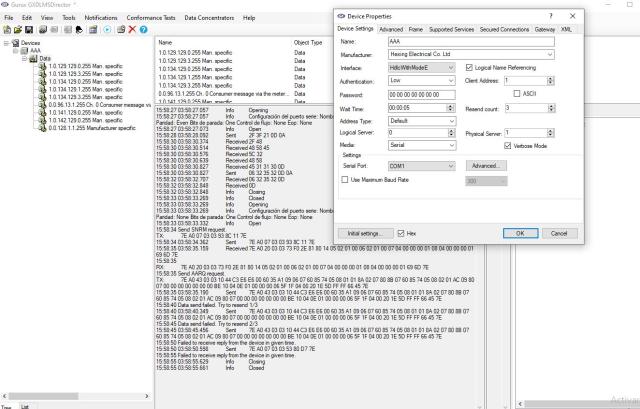

And I attach the Director capture (I made a lot of combinations, but I cant to communicate with the meter).
I appreciate a lot your help to figure out the initial parameters,
Thanks and regards
Alejandro
4 years 5 months ago
Can you connect without authentication? Meter succeeded in the first step, but it echoes the client's message in the second step and the meter doesn't reply to the correct message. I believe that your client's address or password is invalid. I check but didn't find the correct client settings for Hexing HEX110.
