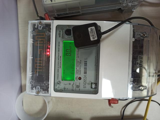

  3. Unable To Read Data From L&T Energy Meter Using Optical Cable
Unable to read data from L&T energy meter using optical cable
By Amit Tiwari , 7 March, 2022
I am new with DLMS.Any help would be great !!
I am trying to read data from L&T smart meter(Manufactured by:Schneider Electric india pvt ltd)) using optical cable.
I get response for SNRM Frame, but there is error response in AARE when i send the AARQ Frame.
The password is correct,i have been ensured by the manufacturer as well as the list of default password as documented by gurux.
I have tried sending frame with none/low/high as mechanism name in combination with with ciphering/without ciphering ACSE tags and have checked each frame with gurux translator for its correct frame format.
In all the cases initiate response comes from LN with ciphering, even if i am not using it in my AARQ. More over the connection is Permanently rejected(01)(Authentication Failure(13))
Considering this, i have tried using various(lower/higher) version ,standard (indian standard/generalised meter standard) dest address as 21,22,23,41,61,81 as hex but response was almost same. (for 81 it was different -Vaa name error)
I have tried using few iterations on conformance block to ask services which are offered by the meter,if thats the issue.Alongwith max PDU size. but nothing has worked so far.
I have tested these input, using both python and gurux director.
I am attaching the log of gurux director,following the result of AARQ/AARE i got while using python serial communication.

4 years 8 months ago
Try to change the client address to 1 when you try to connect with Low authentication. If that doesn't help try to change the physical server address to 0x20.
Your public read for python fails, because your client address is 0x20 and not 0x10.

I have tried what you said,
correct me if i misunderstood something, thanks.
Try with this:
Try to connect with GXDLMSDirector. Set physical server address to 1. The authentication level is Low and the Client address is 0x20.
Select "Supported Services" and un-check "General block transfer". Your settings look correct. It might be that the meter is configured to use ciphering with a low authentication level. You can try a secured connection if you have block cipher and authentication keys.

Your settings are now exactly the same as in http://www.gurux.fi/node/18816
It looks like your meter expects ciphered connection.

Now, i am able to communicate with the meter.Indeed ciphering was required.
I do have the keys,iv,ic and block cipher, but I am unable to decrypt cyphertext back to plaintext, if I am not using guruxdirector.
I want to read data continuously, can you help me with this AAD part,
I am sharing the log below :
