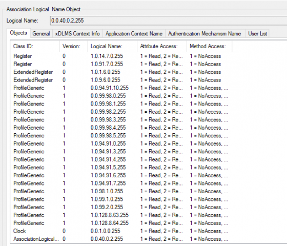

When I read Association logical name using gxDLMSDirector with low authentication i observed that some profiles have 1=No Access. please check in Image attached. What is the meaning of that.
5 years 3 months ago
NoAccess means that you can't use those methods without a higher authentication level. For example with a profile generic object, you can't reset the buffer.
