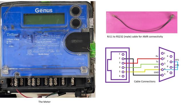

I have a need to read DLMS data from a meter from Genus (picture attached). It also has a RJ11 to RS232 (male to male) cable accompanying it with which the AMR connects and can read the DLMS data. Unfortunately I do not have access to the AMR.
Though I am good with RS232 communication, I do not have much idea of DLMS protocol and thus am unable to read the meter. I have tried sending the standard "/?!" to the meter directly using terminal but of no use. I even tried combinations to baud rates (300, 9600), stop bits, partiy etc. but to no avail. Need your help on this

Thereafter, I borrowed a hardware reader from a freind.
With that reader I could draw the following conclusion.
The serial communication is perfect and is standard 9600, n 8 1.

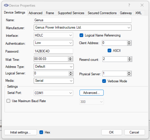

However, the first request from the reader and GxDLMSDirector is different
From Reader
7E C2 A0 20 21 7D 6F C3 AF 7E
From GxDLMSDirector (even the length is short)
7E A0 07 03 01 53 30 E4 7E
I believe this is due to settings (my settings screen attached).
Can you help identifying what is it that I am doing wrong?
4 years 6 months ago
You have changed the client address to zero. Change it to 0x20 and try again.

1. What are the settings to get the same data through GxDLMSDirector?
(Particularly the fields, Interface, Authentication, Password, Address Type,
Client Address, Physical Server, Logical Server)
2. What Gx library would be best to test it on .Net and Arduino platform?
1. Select the Indian standard to the manufacturer. The interface is HDLC.
