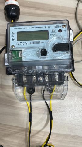

I have an EM 101+ meter with me which I purchased from the market. Here is a picture of it
There is no mention of the word DLMS anywhere on the meter.

We have been at it for the past 2 days but no luck.
We are neither getting a response back on the SNRM nor on the disconnect. However, we believe that for one random time we did get a response back on the disconnect command but we don't have that log.
The cable works on Genus and Secure Meters' meters and we are able to read the data into the GuruX director as well but we don't know what we are missing here and we are assuming that the EM101+ is infact a DLMS meter.
Our meter is manufactured in late 2021 if that helps!

There is no DLMS label on the cover of the meter. Some manufacturers are using the same model number and in some versions DLMS is used and in some versions propriety protocol is used. For this reason, I can't say for sure if your meter supports DLMS or not.
You need to ask is DLMS supported or not by the meter vendor.

We understand that the meter is IS 13779 and not IS 15959 compliant
