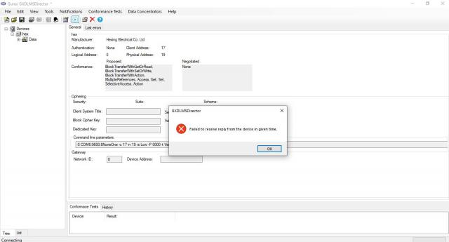

I did as you wrote, but
I did as you wrote, but nothing came of it. The counter constantly, without a request, sends some data. Like these ones -
80 80 80 0000 80 00 8080 80 0080 00 80 0000 80 00 800000 80 00 000000 00 0000 80 80 00 80 0080 80 00 80 0080 80 80 0000 80 00 8080 80 0000 80 00 8080 0000 80 00 0000 80 80 80 000000 00 80 0080 0000 00 80 000080 00 80 0080 0080 00 00 0000 80 00 80 8080 0000 00 000000 00 0000 00 80 000080 00 80 80 000080 00 80 80 000080 00 80 80 80 800000 80 0080 0080 80 80 80 000000 00 80 0080 00 80 0080 0000 80 0080 0000 00 0080 0000 00 000000 00 0000 00 00 0000 00 80 000000 00 0000 80 80 80 80 8080 80 80 80 0080 80 00 80 8080 80 0000 80 0080 0080 80 80 80 000000 00 80 0080 00 80 0080 0000 80 0080 0080 00 80 0080 0000 00 0000 00 00 0000 00 000000 00 80 000000 00 0000 80 80 80 80 8080 80 80 80 0080 80 00 80 8080 80 0000 80 0080 0080 80 80 80 000000 00 80 0080 00 80 0080 0000 80 0080 0000 00 80 0080 0000 00 0000 00 00 0000 00 000000 00 80 000000 00 0000 80 80 80 80 8080 80 80 80 0080 80 00 80 8080 80 0000 80 0080 0080 80 80 80 000000 00 80 0080 00 80 0080 0000 80 0080 0080 00 00 0080 0000 00 0000 00 00 0000 00 000000 00 80 000000 00 0000 80 80 80 80 8080 80 80 80 0080 80 00 80 8080 80 0000 80 0080 0080 80 80 80 000000 00 80 0080 00 80 0080 0000 80 0080 0000 80 80 0080 0000 00 0000 00 00 0000 00 000000 00 80 0000 00 000000 80 80 80 80 8080 80 80 80 0080 80 00 80 8080 80 0000 80 0080 0080 80 80 80 000000 00 80 0000 00 80 0080 0000 80 0080 0000 00 0080 0000 00 0000 00 00 0000 00 000000 00 80 000000 00 0000 80 80 80 80 8080 80 80 80 0080 80 00 80 8080 80 0000 80 0080 0080 80 80 80 000000 00 80 0000 00 80 0080 0000 80 0080 0080 00 80 0080 0000 00 000000 00 0000 00 00 0000 00 80 000000 00 0000 80 80 80 80 8080 80 80 80 0080 80 00 8080 80 80 0000 80 0080 0080 80 80 80 000000 00 80 0000 00 80 0080 0000 80 0080 0000 00 80 0080 0000 00 000000 00 0000 00 00 0000 00 80 000000 00 0000 80 80 80 80 8080 80 80 80 0080 80 00 80 8080 80 0000 80 0080 0080 80 80 80 000000 00 80 000000 80 00 80 0000 80 0080 0080 00 00 0080 0000 00 0000 00 00 0000 00 000000 00 80 0000 00 000000 80 80 80 80 8080 80 80 80 0080 80 00 80 8080 80 0000 80 0080 0080 80 80 80 000000 00 80 000000 80 00 80 0000 80 0080 0000 80 80 0080 0000 00 0000 00 00 0000 00 000000 00 80 0000 00 000000 80 80 80 80 8080 80 80 80 0080 80 00 80 8080 80 0000 80 0080 0080 80 80 80 000000 00 80 0080 0000 00 80 000080 00 80 0000 00 0080 0000 00 0000 00 00 0000 00 000000 00 80 0000 00 000000 80 80 80 80 8080 0080 80 000000 80 00 8080 0080 80 80 80 000080 0080 0080 80 80 80 000000 00 80 0080 0000 00 80 00 0080 00 80 0080 0080 00 80 000000 00 0000 00 000000 00 000000 80 00 0000 00 00 0080 80 80 80 80 800080 80 000000 80 00 8080 0080 80 80 80 000080 0080 0080 80 80 80 000000 00 80 0080 00 00 0080 0000 80 0080 0000 00 80 0080 0000 00 000000 00 0000 00 00 0000 00 80 000000 00 0000 80 80 80 80 8080 0080 80 000000 80 00 8080 0080 80 80 80 000080 00 80 0080 80 80 80 0000 00 00 800080 00 00 0080 0000 80 0080 0080 00 00 0080 0000 00 000000 00 0000 00 00 0000 00 80 000000 00 0000 80 80 80 80 8080 0080 80 000000 80 00 8080 0080 80 80 80 000080 0080 0080 80 80 80 000000 00 80 0080 00 00 0080 0000 80 0080 0000 80 80 0080 0000 00 000000 00 0000 00 00 0000 00 80 000000 00 0000 80 80 80 80 8080 0080 80 000000 80 00 8080 0080 80 80 80 000080 0080 0080 80 80 80 000000 00 80 000080 80 00 80 0000 80 0080 0000 00 0080 0000 00 0000 00 00 0000 00 000000 00 80 0000 00 000000 80 80 80 80 8080 0080 80 000000 80 00 8080 0080 80 80 80 000080 00 80 0080 80 80 80 0000 00 00 800000 80 80 0080 0000 80 0080 0080 00 80 0080 0000 00 0000 00 00 0000 00 000000 00 80 0000 00 000000 80 80 80 80 8080 0080 80 000000 80 00 8080 0080 80 80 80 000080 00 80 0080 80 80 80 0000 00 00 800000 80 80 0080 0000 80 0080 0000 00 80 0080 0000 00 0000 00 00 0000 00 000000 00 80 0000 00 000000 80 80 80 80 8080 0080 80 000000 80 00 8080 0080 80 80 80 000080 0080 0080 80 80 80 000000 00 80 000080 80 00 80 0000 80 0080 0080 00 00 0080 0000 00 0000 00 00 0000 00 000000 00 80 0000 00 000000 80 80 80 80 8080 0080 80 000000 80 00 8080 0080 80 80 80 000080 0080 0080 80 80 80 000000 00 80 0000 80 80 0080 0000 80 0080 0000 80 80 0080 0000 00 000000 00 0000 00 00 0000 00 80 000000 00 0000 80 80 80 80 8080 0080 80 000000 80 00 8080 0080 80 80 80 000080 00 000080 80 80 00 0000 00 80 00 800000 00 80 000080 00 80 0080 0080 80 00 80 0000 00 0080 0000 00 0000 00 00 800080 80 00 80 8080 80 0000 80 0080 0080 80 80 80 000000 00 80 0000 00 80 80 0080 0080 00 80 80 800080 00 00 000080 00 00 0000 00 000000 00 000000 80 00 0000 00 00 0000 00 80 80 8080 80 80 80 80 8080 0080 80 80 80 000080 00800080 80 80 80 000000 00 80 0000 00 80 00 0080 0080 00 80 80 800080 00 00 0000 80 00 000000 00 000000 00 0000 00 80 00 0000 00 000000 00 80 80 8080 80 80 80 8080 80 0080 80 80 80 000080 0080 0080 80 80 80 000000 00 80 000000 80 80 00 0000 80 00 80 8080 0080 00 00 0000 80 00 000000 00 0000 00 00 0000 00 80 000000 00 000000 00 80 80 8080 80 80 0080 80 000000 80 80 00 80 8080 80 0000 80 0080 0080 80 80 80 000000 00 80 0000 00 80 00 8080 0080 00 80 80 800080 00 00 0000 80 00 000000 00 0000 00 00 0000 00 80 000000 00 0000 00 00 8080 80 80 80 80 0080 80 000000 80 80 00 80 8080 80 0000 80 0080 0080 80 80 80 000000 00 80 0000 80 80 80 0080 0080 00 80 80 800080 00 00 0000 80 00 000000 00 000000 00 0000 00 80 00 0000 00 000000 00 80 80 8080 80 80 80 8080 80 0080 80 80 80 000080 00 80 0080 80 80 80 0000 00 00 800000 80 80 00 0080 00 80 00 8080 80 0080 00 00 0000 80 00 000000 00 000000 00 0000 00 80 00 0000 00 000000 00 80 80 8080 80 80 80 8080 80 0080 80 80 80 000080 00 80 0080 80 80 80 0000 00 00 800000 80 80 80 0000 00 80 00 8080 80 0080 00 00 0000 80 00 000000 00 0000 00 00 0000 00 80 000000 00 0000 00 00 8080 80 80 80 80 0080 80 000000 80 80 00 80 8080 80 0000 80 0080 0080 80 80 80 000000 00 80 0000 80 80 00 8080 0080 00 80 80 800080 00 00 0000 80 00 000000 00 000000 00 0000 00 80 00 0000 00 000000 00 80 80 8080 80 80 0080 80 000000 80 80 00 80 8080 80 0000 80 0080 0080 80 80 80 000000 00 80 0000 80 00 80 0080 0080 00 80 80 800080 00 00 0000 80 00 000000 00 000000 00 0000 00 80 00 0000 00 000000 00 80 80 8080 80 80 80 8080 80 0080 80 80 80 000080 00 80 00 8080 80 80 0000 00 00 800000 80 00 00 0080 00 80 00 8080 80 0080 00 00 0000 80 00 000000 00 000000 00 0000 00 80 00 0000 00 000000 00 80 80 8080 80 80 80 8080 80 0080 80 80 80 000080 00 80 0080 80 80 80 0000 00 00 800000 80 00 80 0000 00 80 00 8080 80 0080 00 00 0000 80 00 000000 00 000000 00 0000 00 80 00 0000 00 000000 00 80 80 8080 80 80 0080 80 000000 80 80 00 80 8080 80 0000 80 0080 0080 80 80 80 000000 00 80 0000 80 00 00 8080 0080 00 80 80 800080 00 00 0000 80 00 000000 00 000000 00 0000 00 80 00 0000 00 000000 00 80 80 8080 80 80 0080 80 000000 80 80 00 80 8080 80 0000 80 000000 80 80 80 000000 00 80 0080 00 80 80 8080 0080 00 00 0000 80 00 000000 80 00 0000 00 80 00 0080 00 00 000000 00 80 80 8080 0080 80 00 80 8080 80 0000 80 000000 80 80 80 0000 00 00 800080 00 00 0080 0000 80 00 80 000000 80 00 80 0080 00 00 0080 00 80 00 8080 0080 80 80 80 000080 00 80 00 0080 80 00 00 80 00
Every ten seconds, this is visible through the monitor port.

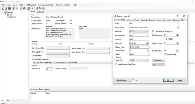

My settings 1
My settings 1
hams
4 years 11 months ago
My settings 2
My settings 2
hams

I don't know what that data is. What baud rate you are using? It looks like your serial port settings are different than the meter.
I have to say that support of the meter manufacturers is usually poor, even you have bought a bigger amount of the meters.
What is your meter serial
What are the last two digits of your meter serial number?
hams
The last two digits are 19.
The last two digits are 19. baud rate - 9600, data bits - 8, parity none, stop bits - one. flow control - none.
Then your settings should be correct. Let's hope that you get the reply from the Hexing.

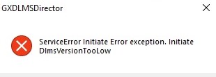

I bought an optical head. Now another error has appeared.
Can you add the hex trace here? I can check the bytes, but this seems like a meter issue. Do you know if there is a firmware update for the meter?

Gurux.DLMS.GXDLMSConfirmedServiceError: ServiceError Initiate Error exception. Initiate DlmsVersionTooLow
в GXDLMSDirector.GXDLMSCommunicator.InitializeConnection(Boolean force)
The meter is sending DlmsVersionTooLow error. It's interesting because the version number is 6 and it's proposed. I believe that the meter is returning an invalid error code and the reason is something else.
Can you connect if the authentication level is None?

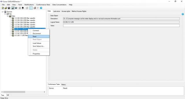

Can you read the association view? Can you see the tree of COSEM objects on the left side?
If you do, you need to select an object that you want to read and then press the read button.

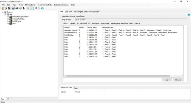

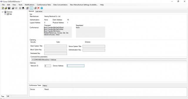

I can see the object tree,
I can see the object tree, but I can’t read anything and the list.
hams
Result.
Result.
Because I don't know what is your version, try to do this.
1. Connect to the meter.¨
2. Select Refresh from the File menu. Is the object tree updated? Try to be fast. There are some older versions where the connection is closed almost right away if nothing is read from the meter. This will cause the meter doesn't reply.

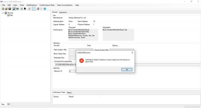

Sorry I didn't do that right
Sorry I didn't do that right away. Now I did it according to your instructions. The counter is connected but after the update there are no objects. Here's the result:

It turned out this:
It turned out this:
hams
Now you need to achieve a
Now you need to achieve a high level connection.

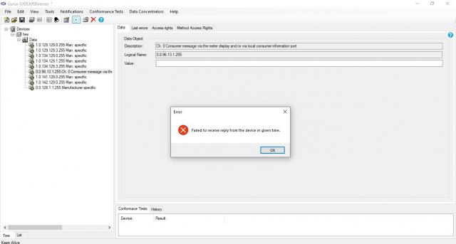

Hello.
Hello.
Yes, now I can read the representations of the associations, thank you for that. When changing authentication to High-level, an error (DlmsVersionTooLow error) appears. Does this mean that the password is incorrect? The meter is new, so the default password is "000000", judging by the manual. But I already tried the default password and without the password tried the error remains the same.
I believe that this error code is wrong and the real reason is that password is something else.
I checked data from the hex string that you post earlier and the content is correct.
So I believe that password or client address is wrong. Check them from the manual.

Thank you for the comments so far. I wanted to add my input.
I got the same results with a HXE310 over RS-485. With Authentication Low I managed to read the tree, but I needed to read the Energy index. With authentication High and trying various passwords (000000, 12345678) I get "Other reason" as connection error. This is when I select Address type: Default. When trying with Serial number the meter times out. I am looking for higher level password to see if I could read the indexes. I also tried the Python Client DLMS example. With Low authentication gives the same results. It looks like I need higher authentication to make it work.
