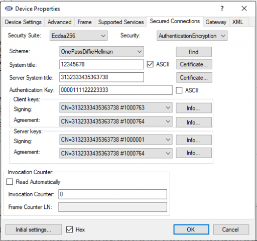

Hii,
My meter is in suite 1 and i want to communicate with the meter in suite 1 mode.
I have successfully shared the certificates of each other (Gurux client and meter) using certificate attributes and methods in suite 0.
Now i have changed the settings from "Secured Connections" tab which snap is attached here with this post.
When i click on connect button i found that Gurux send AARQ frame request in which No signing tag and no signature is there in the frame:

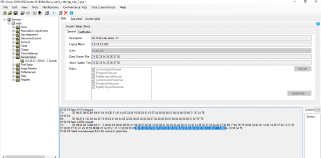

Connect to the device and read Security setup. Check that Suite is Ecdsa256 and not GMac or Ecdsa384.
http://gurux.fi/PublicKeyCryptography
Change suite to Ecdsa256 if it's GMAC.

I have set the suite to ecdsa256, but problem remains same.
Please find the attached snaps
Log:
15:54:39 Send SNRM request.
TX: 7E A0 23 00 02 BA 69 61 93 FA DD 81 80 14 05 02 01 F5 06 02 01 F2 07 04 00 00 00 01 08 04 00 00 00 01 2C 01 7E
15:54:39
RX: 7E A0 23 61 00 02 BA 69 73 09 85 81 80 14 05 02 02 00 06 02 02 00 07 04 00 00 00 01 08 04 00 00 00 01 6F EF 7E
15:54:39 Send AARQ request.
TX: 7E A0 6E 00 02 BA 69 61 10 20 82 E6 E6 00 60 5D A1 09 06 07 60 85 74 05 08 01 03 A6 0A 04 08 31 32 33 34 35 36 37 38 8A 02 07 80 8B 07 60 85 74 05 08 02 02 AC 12 80 10 26 37 2A 12 31 51 1F 5D 04 07 53 4D 25 29 59 5E BE 23 04 21 21 1F 31 00 00 00 00 8E 91 A5 76 70 B8 F3 EF 2A D9 34 56 84 50 9D 86 AC 9C 58 CE 2E 61 13 0B CA 1D 51 04 7E
15:54:49 Failed to receive reply from the device in given time.
5 years 8 months ago
In the pic your server system title is not correct. Is the meter our example meters or is it the real meter?
aoudumbarpawar
Hii,
Hii,
This is my testing meter and i have put server meter system title to 12345678
