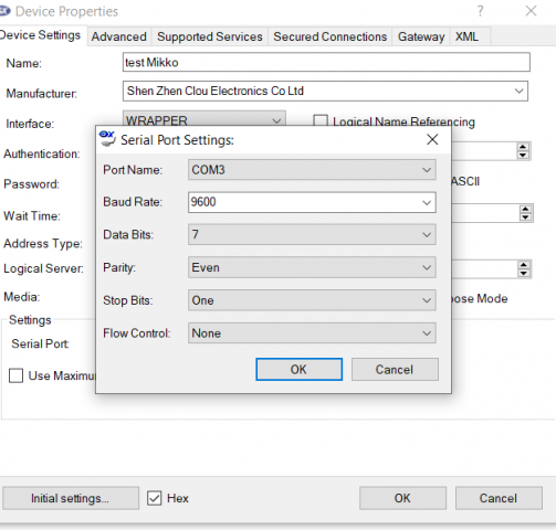

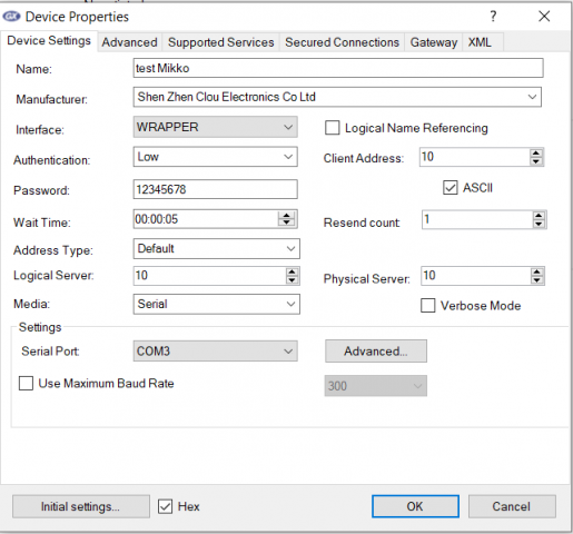

I try connect with this configuration:
Authentintication level: Low
Interface type: WRAPPER
Client address: 0x10
Server address: 0x10
Password: 12345678
But it isn't work...

Is your meter connected to the serial port or do you try to connect using TCP/IP connection?

I'm connecting with rs485

com config
com config

5 years 9 months ago
config
config
I checked the documents that you sent to me. I'm not sure if you can connect with DLMS using the serial port. You need to ask is it possible from the meter vendor. In the documents there communication with DLMS is shown only between TCP/IP server and GPRS meter.
