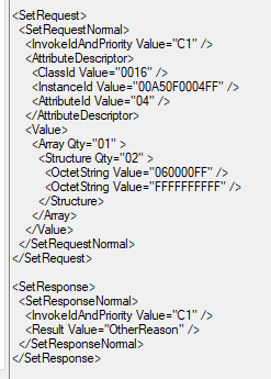

with GXDLMSDirector, writing attribute execution_time of an Single action schedule objects returns an error. I assume the reason for this is, that the 'hundredths' part of time is set to 0xFF.
GB Part2, page 49 states: "For hour, minute, second and hundredths: 0xFF = not specified."
See file for transmission.
Thanks in advance

"not specified" works with most of the meters and it basically means that it's ignored: I know that some meters expect that hundreds are set to zero. Is this the case with your meter?

we would like to be as close to the specification as possible. This helps us in the In case if/when the DLMS conformance test gets more strict and would fail with this violation (even though it is small)
4 years ago
Then you need to handle this on the meter and if it's oxFF you need to skip it.
You can find more information from this in the Blue Book 4.1.6.1 Date and time formats.
Martin Wick
4 years ago
I miss read the information in Blue Book 4.1.6.1.
I'll implement as you suggest. Thanks a lot for your help.
