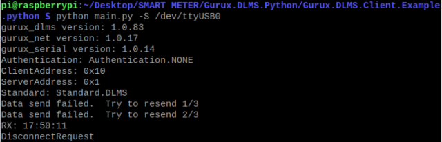

I've already tried it, but unfortunately it didn't work. (Photo is attached). With the command: sudo screen -l / dev / ttyUSB0 -s 115200 --parity = none: So I get a terminal where I get data sent every second.
My current electricity provider told me that this character is encrypted with AES 128 and that you can only make it readable with GURUX later, for example.
In addition, I know that the electricity meter can only send and not receive. How can I now write a script where the data is omitted, decrypted and processed.
Unfortunately, I cannot say how to do it. I hope you can help me

In this case, you don't use the client example. It'll make a connection to the meter and reads data from it.
You need to use Gurux.DLMS.Push.Listener.Example.python

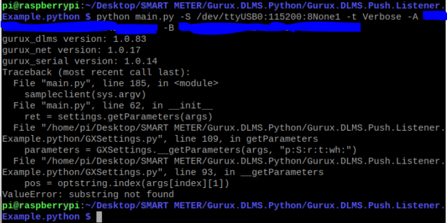

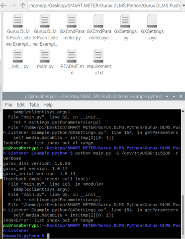

Hello and thx,
something did not work during the attempt. Picture attached.
What do you mean by (Then you need to set the authentication and block cipher keys.) Or how can I do that?
UnknownExe
6 years 3 months ago
My mistake- The parameter is:
python main.py -S /dev/ttyUSB0:115200:8None1 -t Verbose
You need authentication and block cipher key from the meter company. Without those keys, you can't decrypt the data. Keys are 16 bytes long keys.

Hello and thanks
Hello and thanks
Have I made a mistake while entering? Or I don't find the mistake.
Have I understood that correctly? So I should not post pictures, just the command?
Yes, don't post the images.
I just checked and command line support for ciphering is missing from the push listener. We'll add command line parameters today.

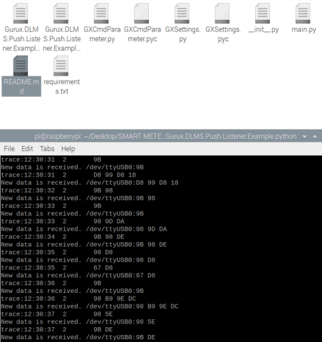

Hello and thanks that went
Hello and thanks that went quickly
Now this command goes: python main.py -S / dev / ttyUSB0: 115200: 8None1 -t Verbose -A AAAABBBBCCCCDDDDEEEEFFFFGGGGHHHH -B AAAABBBBCCCCDDDDEEEEFFFFGGGGHHHH
But the values I get look like this: New data is received. / dev / ttyUSB0: 1C 73 76
trace: 10: 40: 28 2 9B 9C A6
New data is received. / dev / ttyUSB0: 9B 9C A6
trace: 10: 40: 28 2 98
How can I read this now?
Kind regards UnknownExe
UnknownExe
I've been thinking but I can
I've been thinking but I can't figure out what that could mean
Check your baud rate. The first (and last) char should be 7E when your serial port settings are correct.

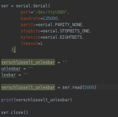

Output from my Python Script Code --> image
b'\x00\xfe`\xf7\xcf\x02c3{\xc5\xe6\xe7\x00\xfb\x08\xc9\xf3\xcb\xe9\xf4\xc6~\xce\xff`\x00\n\xee2\xfb\x02\xf0\xc3\xf8\xed6\xeaa\xc8\xf0\xe0?\x0cu\xca\xf4\xfe\x06s\xc2\xf0\xf1j\x0b\xf9\xe5el:\xc0\xfe\xc3\xf0\x00h\xfc\xc5\xfd\xe4}\xc4\x05\xea4\xeb;\x04\xfb\xf3\x0b\xc9l\x0e\xc2ob5\x03\xc0\xfc\xe5vx\xef=\xf9\x01\x00d\x08\x0c\xc7\xf1\xf8d\xfa\xe1\xf1\xf69exz\xf6\xea\nw\xf1\xf2\xc6n\xec\xfe\xfe`\xf7\x00\xcf\x02c3{\xc5\xe6\xe7\x00\xfb\x08\xc9\xf3\xcb\xe9\xf4\xc6~\xce\xff`\x00\n\xee3\xff\xf6\x00\xfc\xf2\xcf\xfe\xf91\xcb\xf2mq\xf0du\xea\xf30u\xca\xffm|f\x05\xc3a`\xf9dh:z\xf75\xf9\x000\xea\xf0\x06\x0e\t\x0b}kt\rj\xcawc\xf8\xfdy\xec7\x00\x07o\xc0\xe1\xe2\xef\xc3\xcai\xce\xfb\xe0f\xc6y7\xf0\x03\xff\xfe:\xf3u{\xc5\xf9\x02y\xeaqf\xf7\x018\xfe\xfe`\xf7\xcf\x02c\x003{\xc5\xe6\xe7\x00\xfb\x08\xfe\xfe`\xf7\xcf\x02c3{\xc5\xe6\xe7\x00\xfb\x08\xc9\xf3\xcb\xe9\xf4\xc6~\xce\xff`\x00\n\xeey>\xe1c\xf8p2\x01d\xe1\xfa874\xf4\xf3\x02\xefm6t\xf8e\xf7\xca\x04\xe0\xe9\xc0\xfd\x07:\xf9\xf38\x06\xc6u\xca\xe0\xf6\xf03h{4\xf4r\xfbs\xf3i\xfa\x04\xe3\xea\xc0n<\xe9\xc1k\xf6~g\xfb\xc76\xff9\xf8|\xf0\xf1\xe2\xf9\xea:\xf4\x01\x0frt\xe4\xc4=\xf4\xe8\xc8\xc3\x04\xefb\xfe'

So I get this output again from my Python script:
0x7ea077cf022313bb45e6e700db0849534b6974463e4e5f2000113c343fd6fc45ce3e85f848a3e8ce0a8daaf470a7f4b0cfad6371cee20ca337664a57356b5a78f341c7605f98b5b7807bf3c03da942e2fedacdd760a891ce10c30680a3e2c1575ca7f2741308bf6ca8e86d197bafa2c6238a66fc5ad791a67e
0x7ea077cf022313bb45e6e700db0849534b6974463e4e5f2000113cba00ca8f26f58af24b1b6365b8aee52886eb94f23727f1fc15cc6f0117b07ffccfd723fa29b3074d37fa21c180d567744ad94c0085031a2bcc069e7fb5f7a3a6f9b021bb745ee0a4a42f2b27651179456d6e3480c1a6637bc8d55f6b747e
0x7ea077cf022313bb45e6e700db0849534b6974463e4e5f2000113cd13153d5bee8baf72650d67088ec149b8be8ee7b5eeeddffa16353e376d635840cb267cb19f1e1d2e026dcd9a0353989ee15ef83c623fb86215ce8e7414f418b5ab51594d1f74d616691538df0ba0edb4e21b3f6db7b8b66b99db744527e
And from the Gurux I get this output (original):
python main.py -S /dev/ttyUSB1:115200:8None1 -t Verbose
gurux_dlms version: 1.0.83
gurux_net version: 1.0.17
gurux_serial version: 1.0.14
/dev/ttyUSB1:115200 8NONE1
Press any key to close the application.
Media state changed. MediaState.OPENING
trace:13:47:16 2 9B
New data is received. /dev/ttyUSB1:9B
trace:13:47:16 2 1C 5B 13 1E DF
New data is received. /dev/ttyUSB1:1C 5B 13 1E DF
trace:13:47:17 2 98 DC
New data is received. /dev/ttyUSB1:98 DC
trace:13:47:17 2 7F 9F 1C
New data is received. /dev/ttyUSB1:7F 9F 1C
trace:13:47:18 2 9B 9C DF 1E
New data is received. /dev/ttyUSB1:9B 9C DF 1E
trace:13:47:19 2 9B
trace:13:47:19 2 1C BD 16 D3 1B
New data is received. /dev/ttyUSB1:1C BD 16 D3 1B
trace:13:47:20 2 BB
New data is received. /dev/ttyUSB1:BB
trace:13:47:20 2 AB 9C 9F
New data is received. /dev/ttyUSB1:AB 9C 9F
trace:13:47:21 2 98 1C 1F 07
New data is received. /dev/ttyUSB1:98 1C 1F 07
trace:13:47:22 2 98 1C
trace:13:47:22 2 B7
New data is received. /dev/ttyUSB1:B7
trace:13:47:23 2 9B 5C 5A 7B
New data is received. /dev/ttyUSB1:9B 5C 5A 7B
trace:13:47:23 2 DC
New data is received. /dev/ttyUSB1:DC
trace:13:47:24 2 9B
trace:13:47:24 2 9C 26 1C 93
New data is received. /dev/ttyUSB1:9C 26 1C 93
trace:13:47:25 2 9B 5C DC
New data is received. /dev/ttyUSB1:9B 5C DC
trace:13:47:25 2 9A
New data is received. /dev/ttyUSB1:9A
trace:13:47:26 2 9B
trace:13:47:26 2 DC 9E D9
New data is received. /dev/ttyUSB1:DC 9E D9
trace:13:47:27 2 9B
trace:13:47:27 2 5C
New data is received. /dev/ttyUSB1:5C
trace:13:47:28 2 9B 1C 1C 1E
New data is received. /dev/ttyUSB1:9B 1C 1C 1E
trace:13:47:28 2 DB D9
New data is received. /dev/ttyUSB1:DB D9
trace:13:47:29 2 9B
trace:13:47:29 2 5C DB
New data is received. /dev/ttyUSB1:5C DB
trace:13:47:30 2 9B 9C 5A DB
New data is received. /dev/ttyUSB1:9B 9C 5A DB
trace:13:47:30 2 4B
New data is received. /dev/ttyUSB1:4B
trace:13:47:31 2 9B
trace:13:47:31 2 5C 7F 73 53
New data is received. /dev/ttyUSB1:5C 7F 73 53
trace:13:47:32 2 9B
trace:13:47:32 2 BC 5E 47
New data is received. /dev/ttyUSB1:BC 5E 47

Hello as I see I get nice
Hello as I see I get nice values in my Python script and a complete nonsense in the Grurux Script. How can I change this so that Grurux gets the same values?
You are right. Your Python returns correct bytes. We are checking why the serial port component returns wrong bytes, but we don't have an answer yet.

Code:
import serial
ser = serial.Serial(
port="/dev/ttyUSB0",
baudrate=115200,
parity=serial.PARITY_NONE,
stopbits=serial.STOPBITS_ONE,
bytesize=serial.EIGHTBITS,
timeout=1
in_bin = ser.read(1000)
in_hex = hex(int.from_bytes(in_bin,byteorder='big'))
print(in_hex)
ser.close()
Best regards
UnknownExe
This is fixed. Update gurux-serial to the version 1.0.15. There was a typo and because most of the meters are using 9600 this was not recognized before.

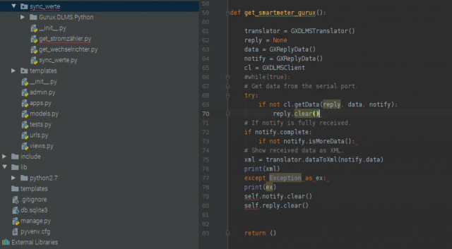

hi
hi
ich glaube ich versteh das nicht ganz. Ich bekomme einen error bei seria1 and reply.clear()
ich hoffe du kannst mir da noch helfen.
def get_smartmeter_gurux():
translator = GXDLMSTranslator()
reply = seria1.read()
data = GXReplyData()
notify = GXReplyData()
cl = GXDLMSClient
#while(true):
# Get data from the serial port.
try:
if not cl.getData(reply, data, notify):
reply.clear()
# If notify is fully received.
if notify.complete:
if not notify.isMoreData():
# Show received data as XML.
xml = translator.dataToXml(notify.data)
print(xml)
except Exception as ex:
print(ex)
self.notify.clear()
self.reply.clear()
return ()
