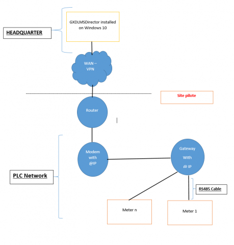

tagmout
6 years 1 month ago
Hey Kurumi ,
Hey Kurumi ,
Our architecture is summarized in the attached picture . in that cas , which interface of device properties we have to use HDCL OR WRAPPER .
If You can please give us the full device properties that we have to use .
Thank You .
6 years 1 month ago
Is your Gateway like Moxa or is it from the meter manufacturer?
If it's Moxa, then you need to use HDLC framing. Are all the meters using the same communication channel or is there an own line for each of the meters?

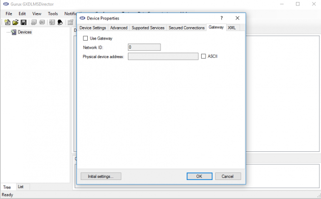

hi Mikko ,
hi Mikko ,
there just 'default' on the choices .
Can You see the attached picture .
tagmout
6 years 1 month ago

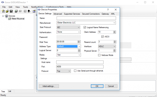

Hi ,
Hi ,
We are using Elster Meter . there is just default in Address Type.
tagmout
6 years 1 month ago

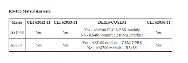

Our Meters are connected to
Our Meters are connected to the gateway by the RS485 cable ,
In that case , If the gateway supports DLMS and the RS-485 don't support ; we can read it ? Can you please check the RS-485 meters answers in the attached picture .
6 years ago
You need to ask this from the meter manufacturer. Only they know it for sure.
