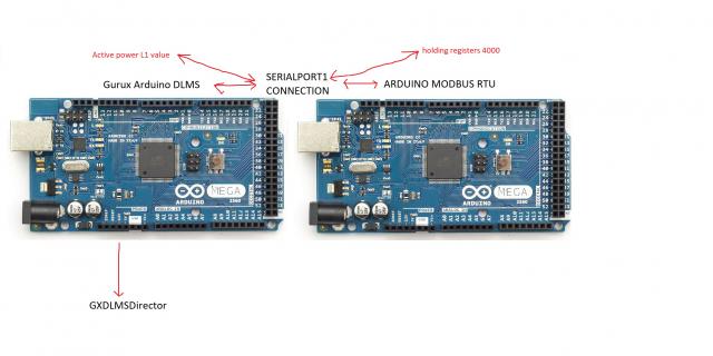

And interested in what else I can do with it? Wanted to connect REAL TIME CLOCK with I2C???
Is it possible, this type of connection as shown in picture???

Pinouts should be the same at all Arduino boards, but just in case check them from the board manufacturer.
You can do whatever you like. The example is simple because we didn't want to add any external HW to it.
You can read/write IOs at the same way as LED is handled.

Implementing Modbus you need to create data and register objects. Then on preRead and preWrite you need to generate Modbus frames and send them to the device.
