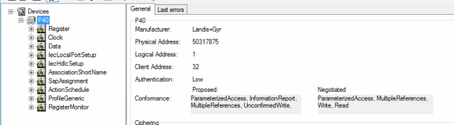

I am trying to read out the parameters of a Landis & Gyr CU-P40 modem. According to Landis the correct logical address should be 17, but everytime I get the full parameters of the meter meter instead.

You need to change "Logical server address" for Landis + Gyr. This is L+G specific way to handle external connection parameters.
Open GXDLMSDirector and change "Logical server address" from zero to 1. Make a connection and read the association view again.

I have used logical server
I have used logical server addres 1, see screenshot (P40). After collection objects the objects in screenshot P40_results are available. For example at register the objects U1, U2, U3, L1, L2 and L3 are shown which tells me the meter objects haven been collected.
6 years 6 months ago
Your physical address is the serial number. Change it to 1. Change also the "Address Type" from SerialNumber to Default.
