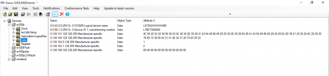

I am used ER300p energy meter(L&T). It is a Indian Standard meter. I am used optical cable to read the dlms data using GXDLMSDirector.
I have get some data from the GXDLMSDirector. After some time, its given a error was fail to receive reply from the device in given time. I was not found data of KWh, KVArh and other. I have attached the screen shot below.

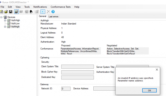

Sir, I am try different energy meter which is sumeru verde company. I given to high level authentication level, Its given a different error, I am attached screenshot of the error. What I doing wrong?
6 years 5 months ago
Your IP address is invalid. Check it.
But I am used optical cable
But I am used optical cable (Serial) to read DLMS data.

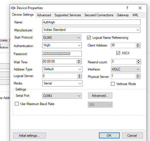

Hi Manish,
Hi Manish,
TCP/IP is the default connection type. Change media to serial from device settings.

I am attached the screenshot
I am attached the screenshot of the meter setting.
Hi Manish,
Hi Manish,
Does this error occur when you make the connection or when you try to read data from the meter?
What you try to read?
Profile picture for user gzpmanish
gzpmanish
When I am try to read data
When I am try to read data from the meter than its given a error?
What you try to read? I believe IP v4 address.
