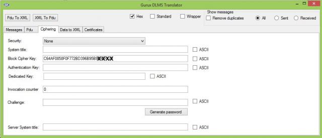

It looks like your meter is sending Wired M-Bus frames but this is a little bit different than what we are receiving usually. Remove header and you can get the data like this:
http://www.gurux.fi/GuruxDLMSTranslator?pdu=DB085341475905E7094781F8200…
Try to decrypt that with GXDLMSDirector. We can check this frame format after next week.
BergAstro
5 years 5 months ago
yes, I use the wired M-Bus via USB-connection to the PC and it works well. As you recommended I entered the data in the director without header (6801016853FF000167DB085341475905E7094781F82000043E1C), but nothing happens. There is also no error message. Are these settings correct?
Change Security to Encryption and set 5341475905E70947 to system title and Server system title.
Then paste PDU to Pdu tab and press "PDU to XML" button. Let me know what happened.

Without the header an
Without the header and according to your hints I got this message:
<DiscoverRequest>
<ResponseProbability Value="227" />
<AllowedTimeSlots Value="101" />
<DiscoverReportInitialCredit Value="218" />
<ICEqualCredit Value="90" />
</DiscoverRequest>
