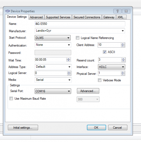

I have an l&g E550 meter ,i cant able to communicate serially or via tcp from gurux to that meter.
i will post my configuration settings from gurux side u can verifi it and say if something is wrong
5 years 10 months ago
Are you using an optical probe or RS-232? Change Start protocol from DLMS to IEC if you are using optical probe.
