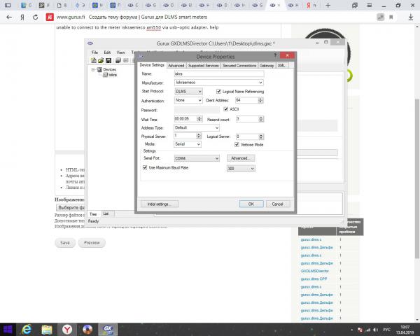

unable to connect to the meter iskraemeco am550 via usb-optic adapter. help

what am I doing wrong?
7 years 6 months ago
Change "Start Protocol" from DLMS to IEC.

Yes. I did it like this. no
Yes. I did it like this. no positive results.
log dlms:
14:00:22 Initializing serial connection.
14:00:23 Send SNRM request.
7E A0 08 02 23 C9 93 E4 43 7E
14:00:28 Failed to receive reply from the device in given time.
14:00:28 Disconnect request
14:00:28 Send Disconnect request.
7E A0 08 02 23 C9 53 E8 85 7E
14:00:33 Failed to receive reply from the device in given time.
log iec:
14:02:01 Initializing serial connection.
14:02:02 HDLC sending:/?!<CR><LF>
14:02:12 Failed to receive reply from the device in given time.
System.Exception: Failed to receive reply from the device in given time.
