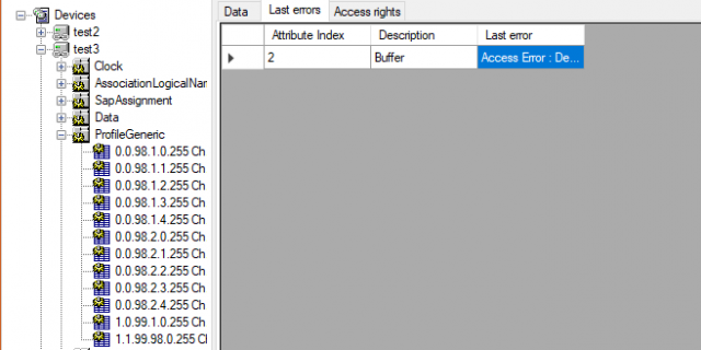

Buffer Access Error
Hi, I've been quite busy. Well, when I try to download data about 3, 4 or 10 days ago the answer is the next:
[13/02/2019 16:58:54] Written data (COM7)
7e a0 19 03 23 32 df eb e6 e6 00 c0 01 c1 00 07
01 00 63 01 00 ff 04 00 84 dd 7e
[13/02/2019 16:58:55] Read data (COM7)
7e a0 15 23 03 52 e5 3f e6 e7 00 c4 01 c1 00 06
00 00 03 84 39 f0 7e
[13/02/2019 16:58:55] Written data (COM7)
7e a0 4c 03 23 54 ae 56 e6 e6 00 c0 01 c1 00 07
01 00 63 01 00 ff 02 01 01 02 04 02 04 12 00 08
09 06 00 00 01 00 00 ff 0f 02 12 00 00 09 0c 07
e3 02 09 06 00 00 00 ff fe d4 00 09 0c 07 e3 02
0e 04 00 00 00 ff fe d4 00 01 00 e4 87 7e
7e a0 11 23 03 74 3d 09 e6 e7 00 c4 01 c1 01 03
73 82 7e
7e a0 19 03 23 76 ff ef e6 e6 00 c0 01 c1 00 07
01 00 63 01 00 ff 05 00 5c c4 7e
7e a0 12 23 03 96 ec e8 e6 e7 00 c4 01 c1 00 16
02 01 23 7e
7e a0 19 03 23 98 8f e1 e6 e6 00 c0 01 c1 00 07
01 00 63 01 00 ff 06 00 34 ee 7e
7e a0 22 23 03 b8 62 6c e6 e7 00 c4 01 c1 00 02
04 12 00 00 09 06 00 00 00 00 00 00 0f 00 12 00
00 7c 19 7e
7e a0 19 03 23 ba 9f e3 e6 e6 00 c0 01 c1 00 07
01 00 63 01 00 ff 07 00 ec f7 7e
7e a0 15 23 03 da a5 37 e6 e7 00 c4 01 c1 00 06
00 00 02 52 5a 5a 7e
[13/02/2019 16:58:56] Written data (COM7)
7e a0 19 03 23 dc af e5 e6 e6 00 c0 01 c1 00 07
01 00 63 01 00 ff 08 00 24 74 7e
[13/02/2019 16:58:56] Read data (COM7)
7e a0 15 23 03 fc 91 73 e6 e7 00 c4 01 c1 00 06
00 00 6a 20 5a a1 7e
and in the tab, "Last errors" appears this:
Buffer
Access Error : Device reports Read-Write denied.
what could be happening?
7 years 7 months ago
Buffer Access Error
Data is correct. Can you check this:
1. Select Read.Set start index to 1 and count to 3. You should receive 3 rows.
2. Select "Read From" and set start and end time to last week. End time must be something else than current date.
