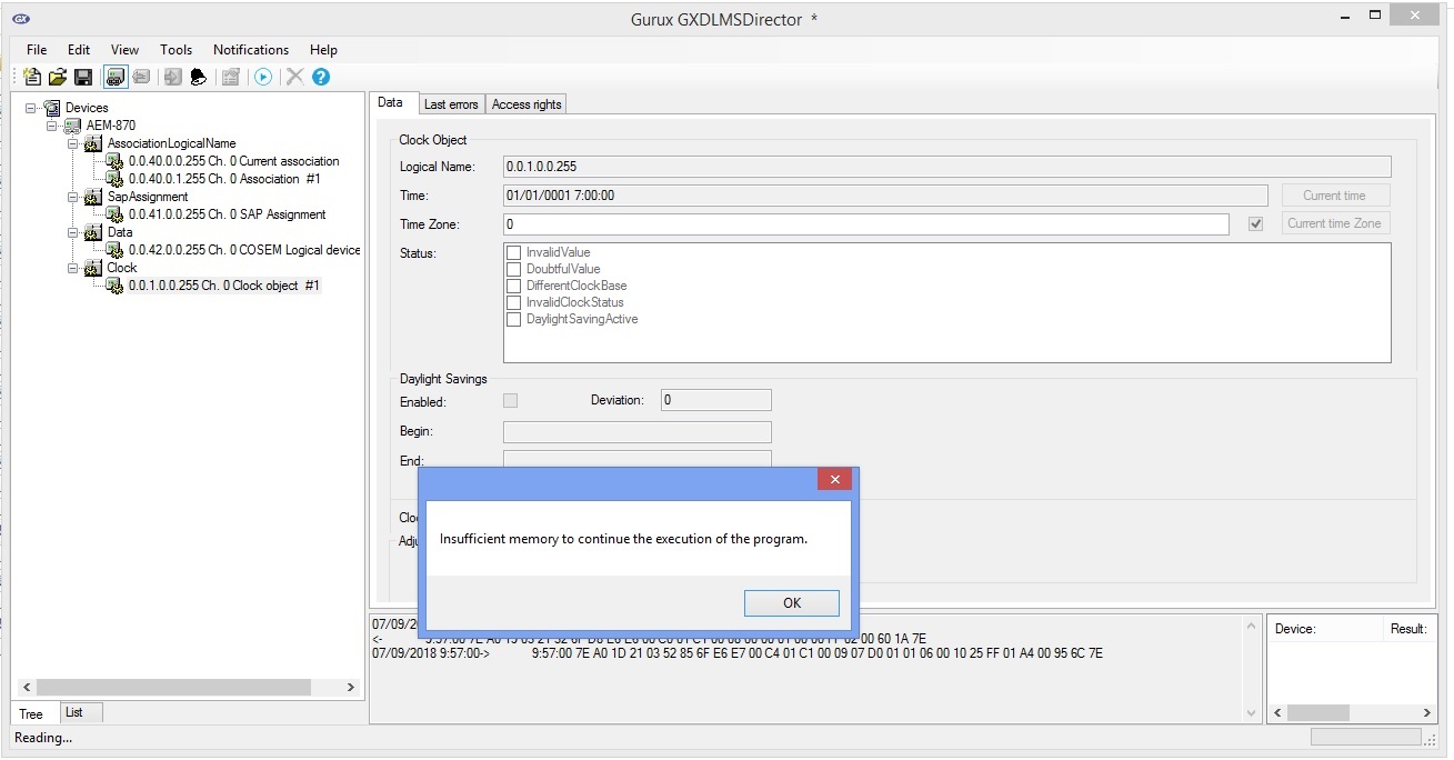

I have used Gurux GXDLMSDirection version 8.1.1807. My meter used Texas Instrument DLMS library. When I connected to my meter with gurux director in lowest authentication (no authentication), we got 4 objects. We can read 3 other objects, but when I read clock object, I got error message Insufficient Memory
Why this problem can happen ? Can you guide us how to solve this problem?

Can you send a log to the forum. Just reading the clock messages is enough.

Here is the clock messages as you requested :
18/09/2018 11:02:04Read object type Clock index: 2
<- 11:02:04 7E A0 19 03 21 32 6F D8 E6 E6 00 C0 01 C1 00 08 00 00 01 00 00 FF 02 00 60 1A 7E
18/09/2018 11:02:04-> 11:02:04 7E A0 1D 21 03 52 85 6F E6 E7 00 C4 01 C1 00 09 07 D0 01 01 06 00 14 13 FF 01 A4 00 70 93 7E

Thanks to this. Date time value is D0010106001413. There are 9 bytes and there should be 12.
So date and time are not correct. First two bytes should be the year and this is not correct.
Your lib or meter is returning wrong data for some reason.

We have corrected the data from the meter, and we have no more Insufficient Memory issue now.
