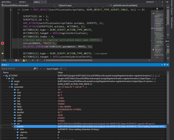

Sadly the tariffication script table write issue is still not fixed. In fact when we are initializing the tariffication script in the addTarifficationScriptTable() function, you added the following which is very clever as idea:
//Action data is register activation mask name (RATE1).
strcat(MASK1, "RATE1");
GX_OCTET_STRING(ACTIONS1[0].parameter, MASK1, 5);
But there is 2 problems (check the picture):
1- instead of making the parameters.vt = DLMS_DATA_TYPE_OCTET_STRING (9) it is equal to 137 weirdly
2 - the byteArr is giving "error reading characters of string"
So when we are triggering the tariffication script and reaching the invoke_ScriptTable() function with "sa->type == DLMS_SCRIPT_ACTION_TYPE_WRITE" the "sa->parameter.vt = 137 != DLMS_DATA_TYPE_OCTET_STRING" so the byteArr is still empty and the cosem_setValue() function is still throwing the same exception. If you please can check it again.
Let me add that hte same problem is happening with current active tariff:
cosem_setValue()-> cosem_setData() -> or value->vt = 137 != 9 -> cosem_getVariant() -> the function bb_getUInt8() is throwing the same exception.
We also noticed that after the prewrite() function in the invoke_ScriptTable() you didn't change
"if (!e->handled)". You have to check it because we are pretty sure that you should replace :
"if (!e->handled)" by "if (!e1->handled)".

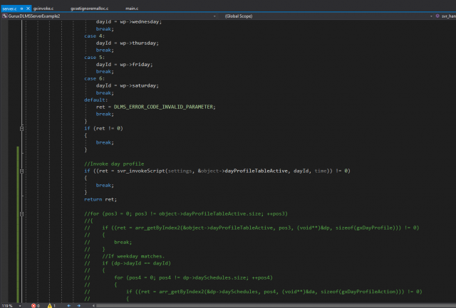

We downloaded the latest version and we are glad to say that most of the issues are solved especially the:
- Tariffication script table write issue
- Special day table checking -> check the dayId table -> check the start time -> trigger the tariffication script table with the desired selector --> trigger the writing of the active mask of the register activation and write the current tariff
One problem remains:
If our current date is not a special day, it will check the season profile then the week profile. This is working like expected. But when reaching the day profile in the function svr_handleActivityCalendar() line 3995 pos3 is looping on the day profile active table to check the correct dayId -> the pos4 will loop on the day profile schedule, compare the start time then trigger the svr_invokeScript() (line 4020). There is 2 problems:
1- First svr_invokeScript() function will again repeat the same work (loop on the dayProfile then the daySchedule then compare the start time). So we are doing the same work twice. After these same steps in the svr_invokeScript() it will finally trigger the tariffication script through invoke_ScriptTable() (line 3854). The issue is that in case we are not a special day we are never reaching the invoke_ScriptTable() due to the repetition, so we will never be able to trigger the tariffication script.
2- Second ret = svr_invokeScript(settings, &object->dayProfileTableActive, da->scriptSelector, time)
The third argument represents the active dayId or you are passing the scriptSelector
Our suggestion is to simply replace the loop pos3 in the svr_handleActivityCalendar() function by the code written in case we are a special day (check the following and the picture) to avoid the repetition and maybe check if the function svr_invokeScript() needs some optimization.
//Invoke day profile
if ((ret = svr_invokeScript(settings, &object->dayProfileTableActive, dayId, time)) != 0)
break;
return ret;
We tested with the above replacement and it worked like expected.

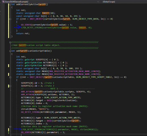

We made some changes in the tariffication script table that leaded us to some issues.
In fact we replaced the octet string by uint8 for the currentActiveTariff object:
In the addCurrentlyActiveTariff() replaced:
GX_OCTET_STRING(currentlyActiveTariff.value, TARIFF, 0)
by
GX_UINT8(currentlyActiveTariff.value) = 1;
In the addTarifficationScriptTable() replaced:
GX_OCTET_STRING(ACTIONS1[1].parameter, MASK1, strlen(MASK1));
by
GX_UINT8(ACTIONS1[1].parameter) = 1;
So when executing the tariffication script table ID=1, first it wrote the active mask of the register activation then it tried to write the value of the current active tariff so it went to:
cosem_setValue()-> cosem_setData() -> cosem_updateVariant() or value->vt = DLMS_DATA_TYPE_UINT8 so it went to cosem_getVariant() -> so in this function it cleared the value using "var_clear" then the bb_getUInt8() throws an exception.
We believed that there is something wrong because cosem_setData has a goal to write and set the new value not to get variant. If you please check it.
Best Regards,
Lara Wakim

In reply to Hi Mikko, by lara.wakim
It fails because the active mask is octet-string and now you try to write int value. We'll add a check here to verify that the value must be an octet-string or an error is returned.
lara.wakim
5 years 7 months ago
We think that you got us wrong. We are trying to write uint8 value for the current active tariff object (type gxData) and not the active mask of the register activation. Check the picture it will clear the misunderstanding.
Best regards,
Lara Wakim
Ps: in case the picture is not clear you can track the changes with [LW]
