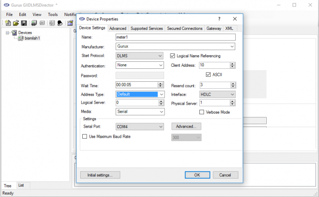

i try with these parameters
i try with these parameters in the attached picture , but no work
below , the logs :

Select Advanced and try to change the baud rate. The easiest is if you ask correct settings from the meter manufacturer.
