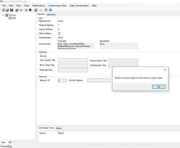

I just try the new code from gitlab, it seem the Arduino server did reply some bytes, but it still show "Failed to receive reply from the device in given time" after awhile.
Please verify is the following Gurux Director new device parameters is correct.
Thank you very much.

What bytes it reply? Note that there are now 2 serial ports in use.
SerialPort is used for communicating and SerialPort2 is used to send trace.
Traces are plain text. Check what data Arduino is sending.
