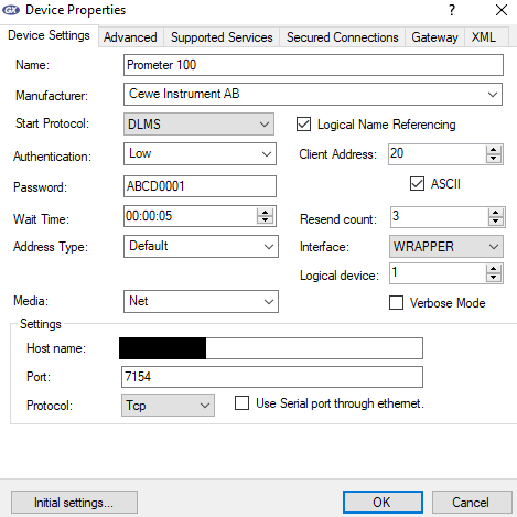

Using DLMS Director I can connect to CEWE Prometer 100 on TCP/IP using the settings in the attached image "Standalone.png".

I was writing an answer to you, and in that process, I should take a couple of screenshots of my problem, and in that process, I actually got this to work (after 10 hours of testing :))
I'm attaching a picture showing how I managed to get a connection. To address the 2 meters separately, I just needed to change the "Physical server" (10 and 11 hex).
