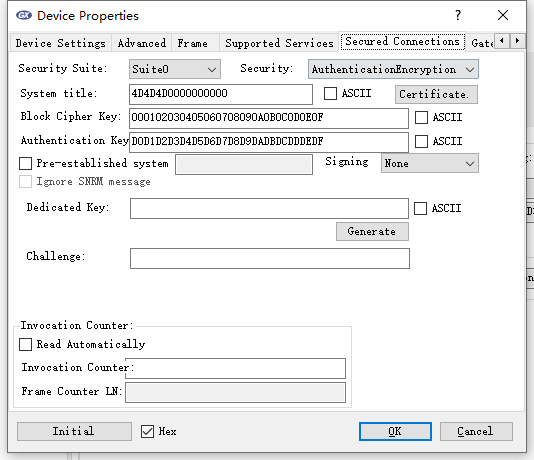

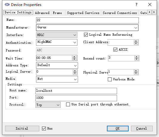

The following image is my configuration,Where is the problem?

Hi, LLC bytes are there, but…
LLC bytes are there, but the server is offering only Get service. Action service is not added. Did you read this meter without authentication and now try to use the same association for the GMAC? You need to read the meter using GMAC association and then use that to simulate the GMAC connection.

Thanks a lot.Now I can…
Thanks a lot.Now I can connect the device successfully.
