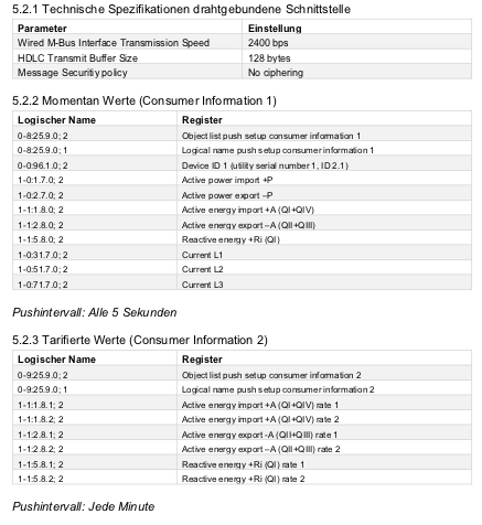

Thx for your replay, from the
Thx for your replay, from the electricity supplier i've got the following information:
4 years 11 months ago
OK, now I get this. You don't establish the connection with the meter. Meter is sending push messages. All you need to do is listen serial port with the correct serial port settings.
Check this. It will do what you want to do.
https://github.com/Gurux/Gurux.DLMS.Python/tree/master/Gurux.DLMS.Push…
There is an interval when push messages are sent. Start app with -t Verbose, so you can see the incoming bytes as a hex string. When the message starts with 7E, your serial port settings are correct.
