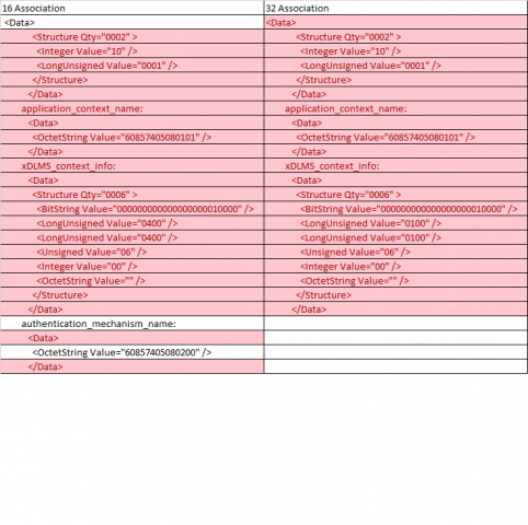

Hi Sir,
Hi Sir,
Please find attached which contains Association 16 and 32.
16 Association got passed but getting "Unexpected max_receive_pdu_size in xDLMS_info" in 32 Association.
Below are the Tx and Rx of Initiation:
