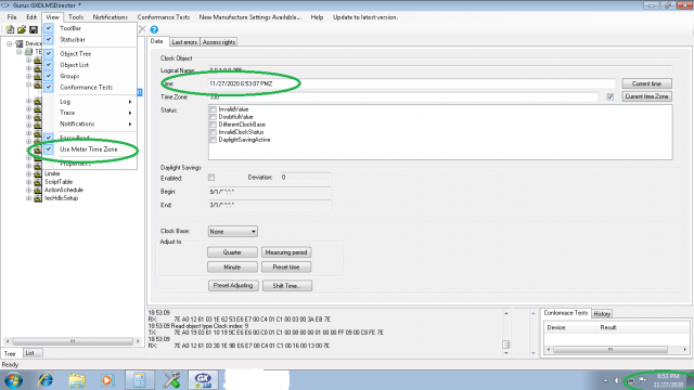

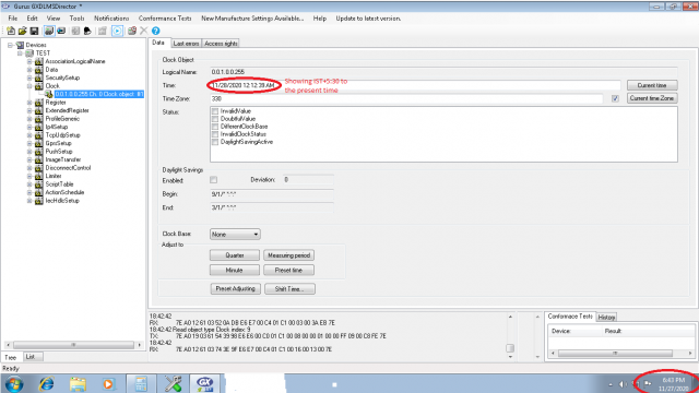

While I am reading a clock from gurux Dlms Director it is showing +5:30 hrs to the meter time. and when I I am using meter timezone option it showing meter time.
Same code I tried with other application there it is working fine but in gurux it is showing 5:30 Hrs Difference.
Please help me where I am wrong & what i have to modify to show clock as same as meter time.
please find attachments of reading clock in gurux dlms Director.

Clock object reading by using
Clock object reading by using meter timezone.

DLMS standard defines that deviation is from normal time to UTC, not UTC time. Your meter is using UTC time. Select meter properties and check "Use UTC time zone, not standard".
Now you can see the correct date-time value.
Ashok_Chowdary
5 years 8 months ago
Thanks for your reply .
After changing the deviation from normal time to utc it showing correct as meter time.
Similarly when i am trying to write clock object In gurux director it is going to +5:30 Hrs to the time what I am writing.
Please help me where I am going wrong and what is the resolution for this?
