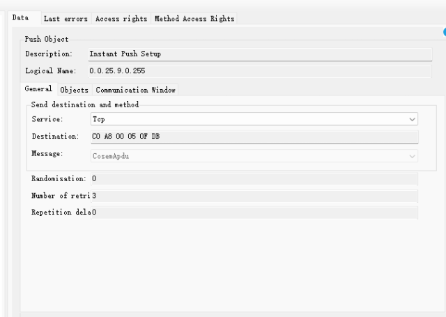

The last question is after reading the PushSetup data in PUSH association, the reading is OK, when
I saved the gxc file after the reading, it gives the prompt message meaning "error found when generating XML file", then the gxc file is damaged which means it cannot be opened successfully again. The data retrieved from the meter is as attached.

Hi, Can you add a screenshot…
Can you add a screenshot from the Objects tab? Your Destination also looks odd. It's usually TCP/IP address. Now I don't know what it is.
